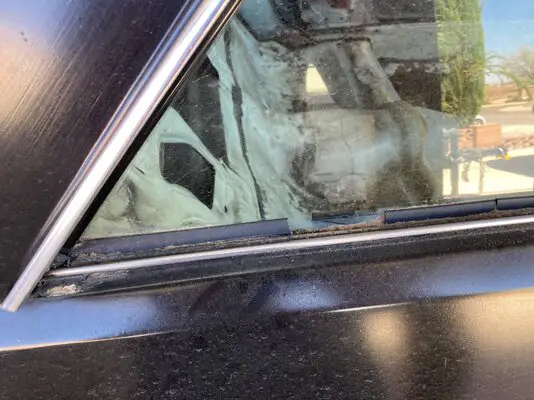

WAS TIME TO STAR SEENG HOW BAD THE CAR WAS SO I PULLED THE INTERIOR
HAD A INTRESTING FUNK TO IT ..
SOMEONE PUT SOME EXTRA SPEAKER HOLES IN THE REAR
MOUSE WAS LIVING IN HERE AT ONE POINT
AND A BATTERY HAD TO HAVE BEEN SITTING IN THE REAR CARPET WAS EATIN AWAY THE WHOLE CAR WAS
OVERLAID WITH FABRIC AND SPRAY GLUED IN SO IT HAD TO GO AND PULLED THE PLUGS AND SCRUBBED TILL CLEAN

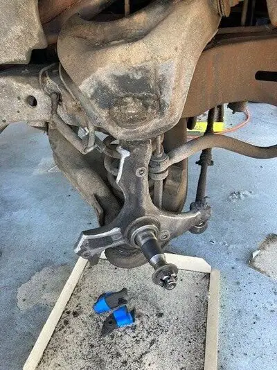

HAVE TO CUT SPINDELS TO ACCEPT THE BRACKETS .. OK THATS EASY
SAWZALL AND GRINDER MADE QUICK WORK OF IT MAYBE 2 HRS AND THIS WAS DONE
LONGEST PART WAS CUTTING THE ROTORS INTO HUBS
TAPE FOR DEPTH GAUGE
DRILL AND TAP DUST SHEILD BOLTS TO "BIGGER" LOL.
DONT REMEMBER FULLY BUT
INFO ON THIS CAME WITH UMI BRACKETS
TAPPED AND CLEANED WITH BRAKE CLEANER
OK THOSE FIT
USED 4" GRINDER WITH CUTTING DISC
MAYBE 10-15MIN TO CUT EACH
END UP WITH THIS
TEST FIT ... I FIND THE REASON WHY THEY MACHINE THEM DOWN I JUST PUT A
STEP IN IT RATHER THEN FULLY REDUCING THE O/D
THE ROTOR HAT ON THE C5/C6 IS TAPPERED SO ITS POSSIBLE TO GET BY WITH THIS
TOSSED THEM ON THE BRAKE LATHE AND FLUSHED UP THE UGLY CUTS AND PUT IN THE STEP
WHEEL STUDS WILL BE REPLACED TO ACCEPT ALUMINUM WHEELS/ SPACERS
