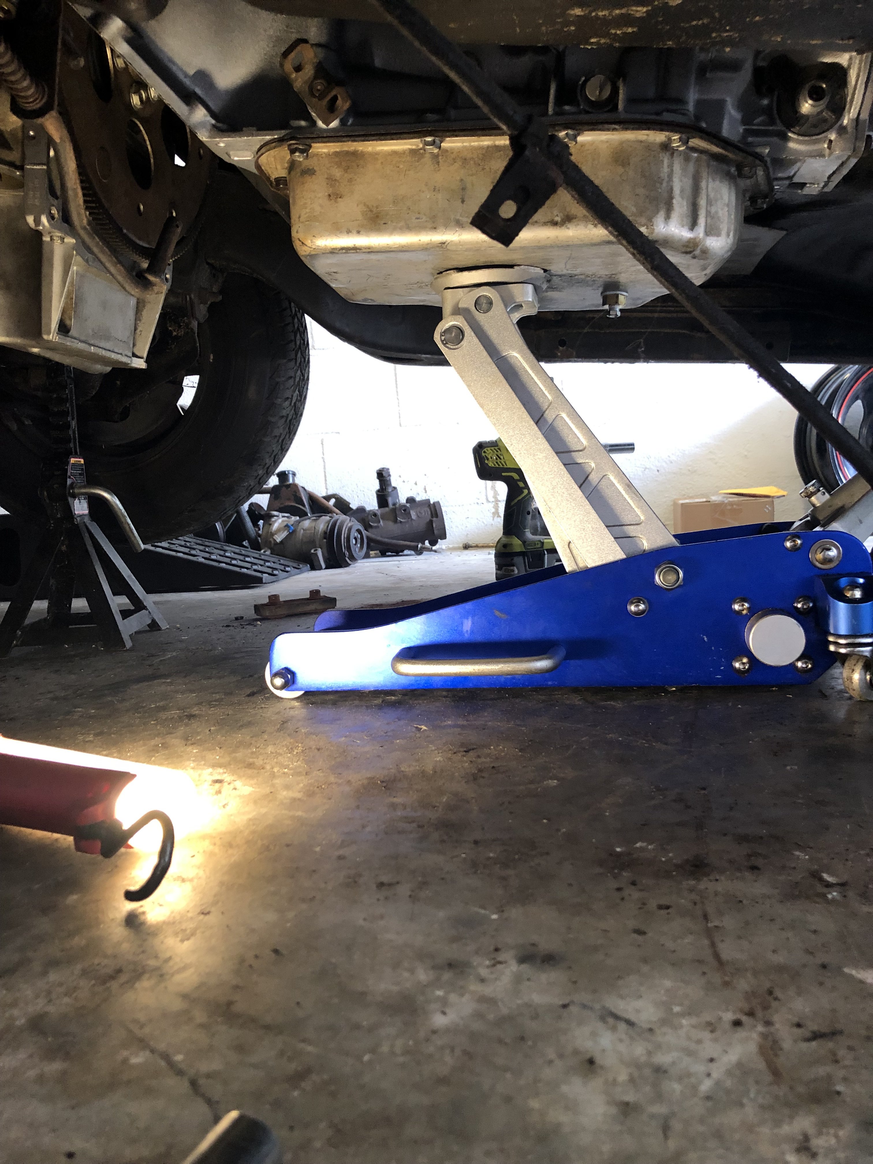

I have a full truck harness/ECU/fuse block when I got the motor. Mathematically I am saving money with the Holley:
Holley Terminator: $900 with $100 off coupon from Summit. I can tune myself, wire and monitor 90% of the things I want. Can use stock speedometer and gas gauge. Win for me.
Truck harness/ECU: Rewire harness (costs time which I value my time @ $$$,
$400), gauges (Tach, A/F, oil pressure, fuel pressure, water temperature, etc etc, easily
$600, buy HP Tuners,
$400 or pay someone to tune $$.
$1400 > $900
Either way, I need the pan
