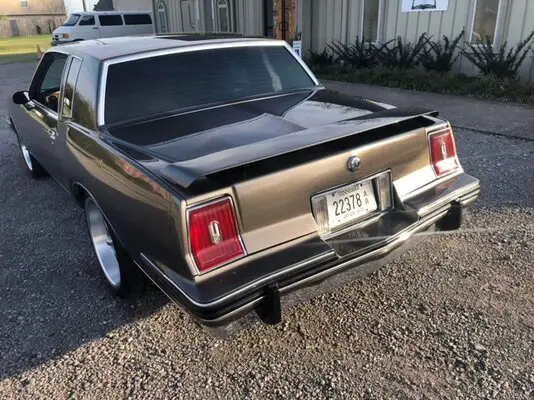

I started this build in 2012. It's taken me this long to almost have it completed. It's a 1984 Pontiac Grand Prix LE. 383 stoker (500Hp). started with a 350 CU. Turbo 400 FTI Transmission, ford 9" rear end 370 gears 35 spline axels with Detroit locker, willwood disc brakes, braded lines, cross drilled and slotted rotors. 14:1 ratio CCP steering gear. new steering linkage , fully adjustable QA1 coil overs all the way around. Spon performance tubular upper and lower control arms and trailing arms. Poly urethane bushings all over including body bushings and motor mounts and transmission mount. UMI frame strengthening kit. G-Force cross member, PEM NASCAR 3" aluminum drive shaft with billet clamps. All new wiring front to back. Vintage Air conditioning system. Vintage air serpentine kit. Holley Sniper fuel injection system with with in tank fuel pump and new fuel tank. The car is 98% complete just waiting on a new radiator to get in. New vintage gauges. Hertz slap stick shifter. Hooker stainless steel headers and 2 1/2" stainless steel dual exhaust with magna flow mufflers.

Love the upgrades and color change, completely different car now.

Beautiful car. Tasteful and understated.

Where did you find the heater/AC box? Never seen one like yours.
Beautiful car, congrats and well done!

The interior looks so nice and comfy. Great job. I like the subtle stripe work.

Congrats, very well done. Didn't think I would like the wheels on it but came together nicely
