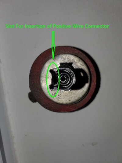

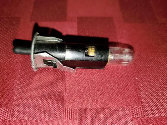

Thanks very much ElCam!! Very helpful! I guess the black wire must still be inside the bottom of the console somewhere. Attaching two more pictures of the switch. It doesn't look as if it is damaged anywhere, but if you see any damage from these angles, please let me know.
Do you know what the tool is that is needed to open the switch to reattach the wire? I'm doubting that GM dealers would have it.

You don't need a tool to put it in just to remove it.
Should slide in the side with the hole in it where you can see the brass from the bulb. It does appear to be intact. It will only lock in one way you might have to turn it over if it doesn't lock in the first try.

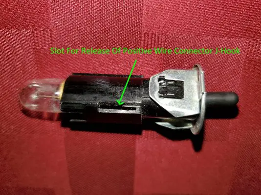

Took another look at the switch, and think that, based on your comments, I figured it out! I think that the positive wire connector simply slides into the slot that I have highlighted in the first picture attached here. And then the second picture shows the slot throough which a small screwdriver can be inserted to depress the side of the J-hook on the connector to release it from the housing. Pretty sure that will do it! Now I just need to take off, or loosen, the console to locate the negative wire, and then slide the wires up through the console to attach to the switch onceit is in place.
Thanks again very much! And for the link to a vendor for the switch. Chris on the Olds / 442 Facebook page was looking for a source.

The corner of the open leg is what holds it in. you slide it in it goes past a little protrusion inside the slot that compresses it slightly, when it passes the protrusion it springs back and holds the terminal in.
There is a special tool but a jewelers screwdriver or eyeglass screwdriver will usually suffice. All you are doing it compressing that free floating leg in just a little so it will clear the protrusion. Push it in and pull the wire out at the same time.
