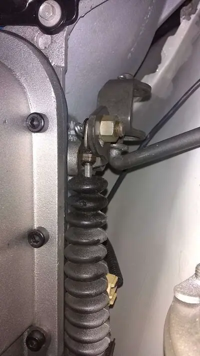

What is this part called that you bolt your shift linkage to?
And is it available new for an 1986 200R4?
Generic picture:
Generic picture:
Sorry not the bracket, the linkage that the backet bolts to. As pictured.

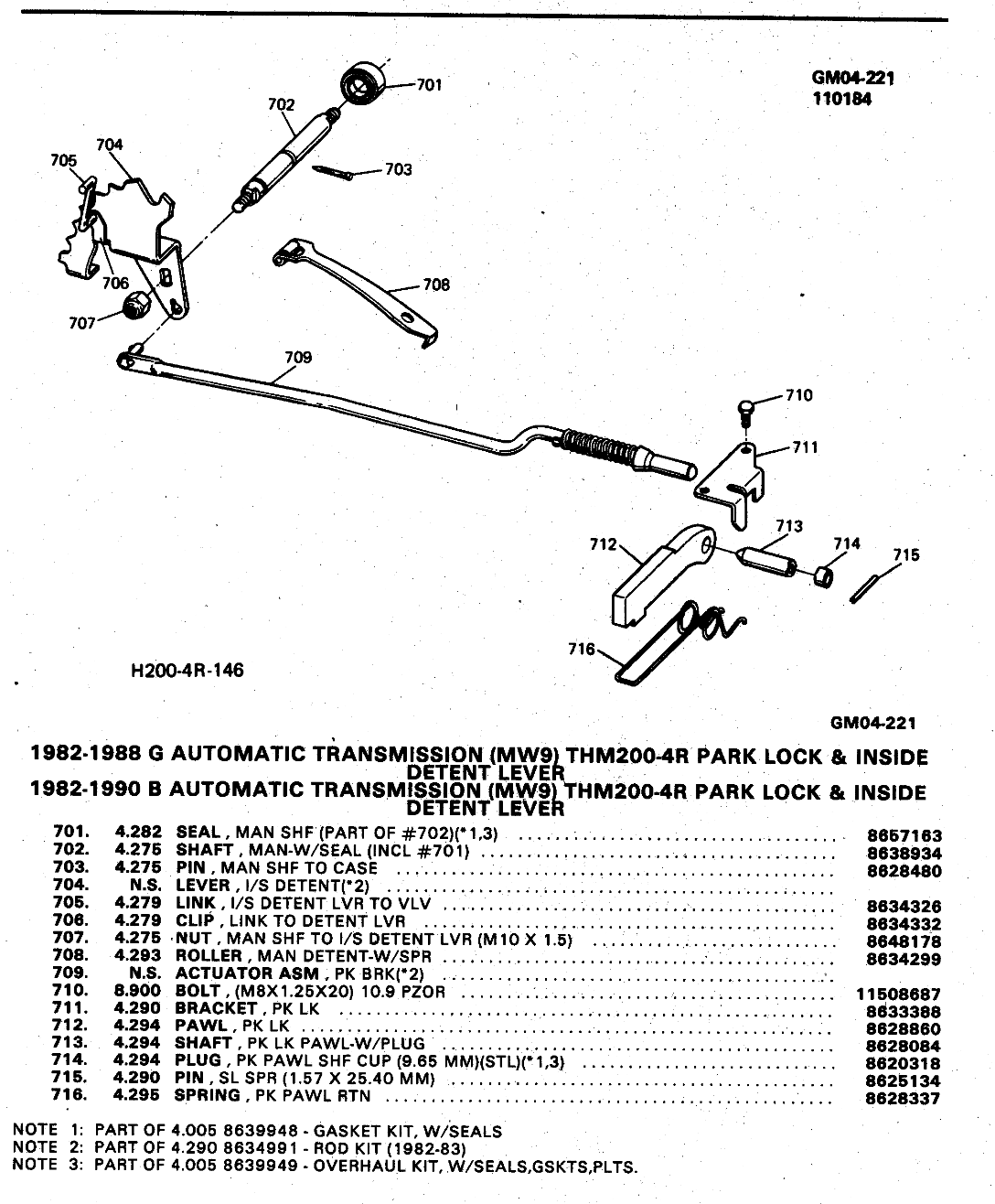

Thanks, that is what I was looking for.Shaft-Manual, with Seal.
Part 702 in the diagram below. Shaft comes with 701 (seal). Part was superseded by 8678940.
DISCONTINUED FROM GMSPO. If you find one, it'll be a third party deal. Not a big wear item.
Here's likely an aftermarket unit.
