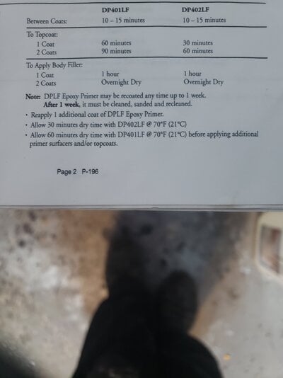

melloelky
Oct 22, 2017
3,714
mass
Oh no I knew what you were getting at I just wanted to try and drive this point home 20220921_093308.jpg

I was taught that body filler only adheres to bare metal and epoxy primer. I personally would not spray primer filler first.
Then again, a lot has changed since I went to school, and there are some good product innovations out there. All I can recommend is to study the P-sheets for everything you want to use, and follow their requirements by the letter. This is too big of a job to have to do over again in 5-8 years.

melloelky
Oct 22, 2017
3,714
mass
evercoat states you can put it over sanded oe finish.i also don't hesitate to put it over a catalyzed product without an issue

RabbitHoleSS
Thread starter
Dec 8, 2019
595
Indianapolis
Awesome bits of info. Spi tech told me basically what your tech sheet says. 2 wet coats wait 24 hr. But he says with it being 85 for the first 6 hrs and never dropping lower then 70, I can start applying filler and high build as early as Tommorow afternoon but waiting 48 hrs is better. Ill probably start bodywork friday. It's gonna be mid 70s this weekend. The high build isn't as temperature sensitive as epoxy either so I can continue thru fall. I used half a gallon of ever coat cheap lightweight filler so far. It's hard to avoid pinholes(ive gotten better with thin costs and pressure)for this rookie, and clogs the paper.I'll probably look into rage ultra since you guys recommend it. Especially if it's easier to sand too.
