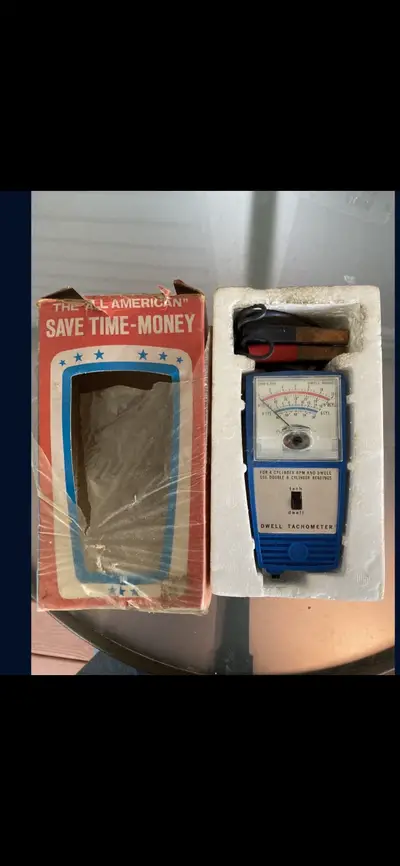

Do you have any suggestions on a descent dwell meter that won’t break the bank. I really want to Learn how to use one.
Nobody seems to make analog dwell meters anymore. About any brand is good asvused is the only option now.

I found this one for $25. I like that it still has a box. What do you think?

Clone TIE Pilot
Aug 14, 2011
3,239
Galaxy far far away
Looks ok from what I can see.
