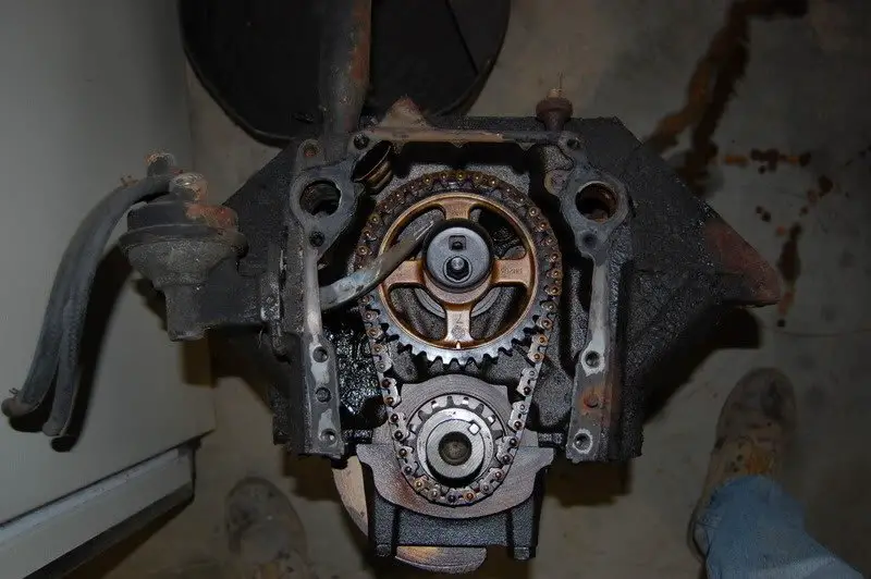

I just did this a few weeks back. Here’s some info from another member that helped me.
heres my thread. Read through my mistakes and hope you get it. Lol.
Also sniped a pic from classic olds that helped me visualize it.
https://gbodyforum.com/threads/replacing-307-water-pump.80172/page-4#post-819029
View attachment 167497 https://gbodyforum.com/threads/replacing-307-water-pump.80172/page-4#post-819029
Yes, that's a good visualization of what I'm blindly trying to do with the pump.
I guess maybe I need to get an inspection camera to see what the major malfunction is. And to think, this should be a 30 minute job, start to finish...
