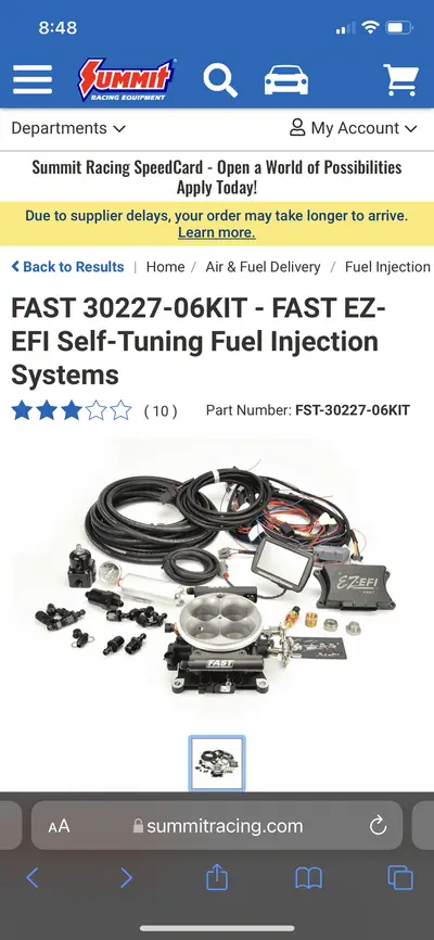

Needing some help before installing this kit. I bought a FAST 30227-06KIT - FAST EZ-EFI Self-Tuning Fuel Injection System for a 78 Malibu. I plan on taking out the OG 305 and installing a 350 SBC. I was wanting to know what else was needed to install this kit and any tips or trouble you may have ran into installing it. I was told I need an Ignition box. Thanks in advance.

Yeah you need an ignition box and coil, maybe an air cleaner/filter also. Overall that looks to be a pretty complete kit. I went ahead and purchased their distributor also, since the ECU can control timing.
The ECU also has a built in electric fan controller, so now is a good time for that upgrade also.
You'll need to do a fair amount of wiring, so be prepared to find a place to mount a bunch of relays and a bus bar for ground, 12v, and switched 12v.
You don't say in your post if you have an aftermarket intake manifold. Usually these kits will not fit factory bolt pattern, I believe you will need an aftermarket manifold.

I've done a little research on the conversion and most of the throttle body kits, FI Tech, Sniper and the likes are usually fairly complete as far as the engine side. You will need to either swap your tank to a fuel injection set up (the best option) or convert yours over. High pressure fuel pump is needed as well as a return line. FI Tech has a fuel command center you can add and keep you original tank but you will still need a return line. When I did my fuel tank, I purchased the 3 tube sending unit instead of the 2 tube just in case I went that route. I hope this helps.

Looks like the fuel pump and regulator is included, per the photo

Some kits do include the pump and regulator, some don't. It kinda comes down to am I saving every penny I can to just afford one or do I scoop some money off the pile and just get it. The nice thing is, there is definitely a range of options and with a little research and help from the Gbody Forum Family you can make the best decision that fits your budget.

This is what I needed. Yes I have an Edelbrock 2701 intake. I wrote down a list of “suggested parts” I need but I was wanting to know what was really needed. Thanks for the info.

I grabbed this kit cause I got it from Summit for $550 from their clearance section. I originally planned on LS swapping but I’ll do this for now. Work on the rest of the car and let the LS be the last on the list now.
