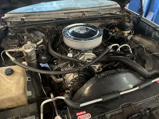

Hello everyone, i found a bone stock 1974 350 with 50k miles and finally put it into my el co but now that it runs good im ready to try my hand at making a bit of power out of it.
