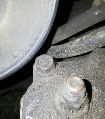

Pull out that bolt and install a button head bolt.
Thats what I did when I ran it
Can I use those for all 4 I am assuming???
