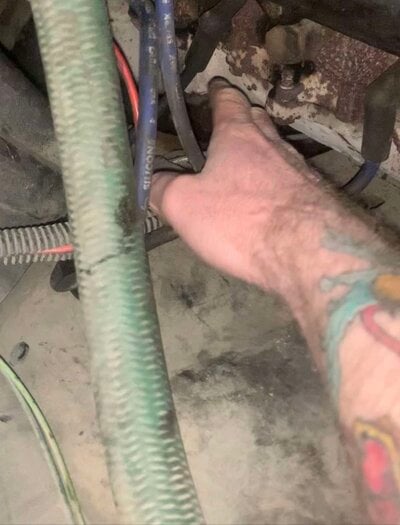

Going out on a limb here Chris but in your video it sounds like an exhaust leak and if you look close at the manifold from the first cylinder on the bank (#2 of the 4,6,8, right side cylinder bank) there appears to be a crack (Thin black carbon line) in the manifold.

You might be right, I unplugged each spark, plug while running and no change.
Oil pressure is still decent. was going to do headers, have any recommendations?

Can you feel any exhaust pulses while holding your hand near the area? When it comes to headers on Oldsmobile engines I have to be honest...I draw a blank. Maybe one of our members versed in Olds engines will chime in. Also fitment into the B body Delta 88 maybe different from the A/G body unless using a universal set from Summit or Jegs. If it is a daily driver I would look for a cast iron manifold if that one is in fact cracked.
My knowledge of Oldsmobile engines was mainly the 394ci that I had in my 61 Olds Dynamic 88 Bubble top. Exhaust wise from experience with that car I know the left side Dual exhaust manifold from a 63 & 64 Olds 394 will fit and work quite well in a 61 & 62.

I do, specifically right here in both areas.
At low RPM's, it doesn't even sound that noticeable. Oil pressure is always between 20-40.
If what you describe in the video, as a pulse then definitely because I felt a leak in that area on both sides.
