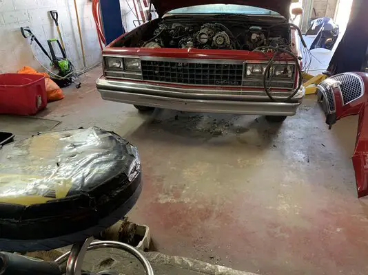

Almost finished with my 83 el Camino 4.8 ls swap using 4l60e trans few things left to tighten up, need to shorten drive shaft, have my radiator rebuilt, and wait for my new oil pan then left is wiring and a few little odds and ends

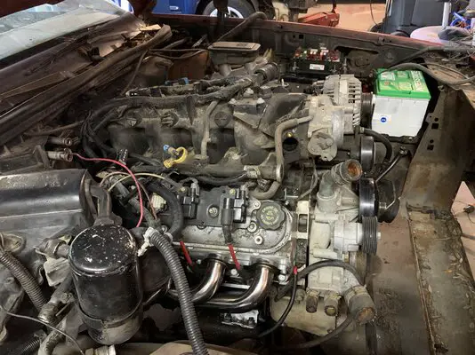

is that the s10 header or g body. Also does your passenger rear coil hit the air box ? Real close to sitting my 5.3 in the 80 Elco.
No it does not and I am not sure they are just eBay speed engineering ls swap headers

Short tube headers may fit easier , but will cost you power over long tubes on an LS engine.
I have shorty headers
they are shorty headers, we just have to make a minor
Adjustment on the drivers side firewall for them to fit other than that everything else fits the truck pan even clears but I offered a jegs oil pan that is designed for ls swap g body’s it was on back order until April but when I called they had one at their other hub and will ship it tomorrow

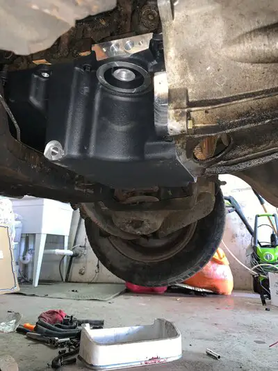

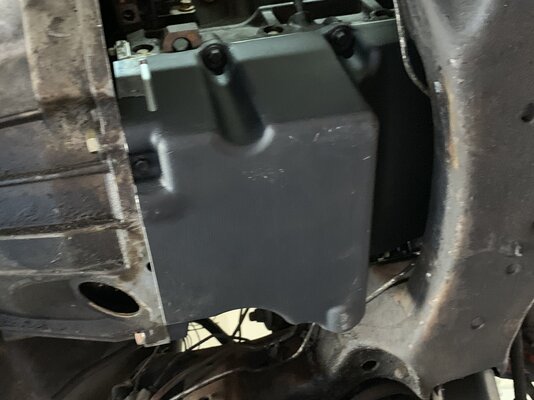

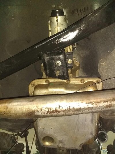

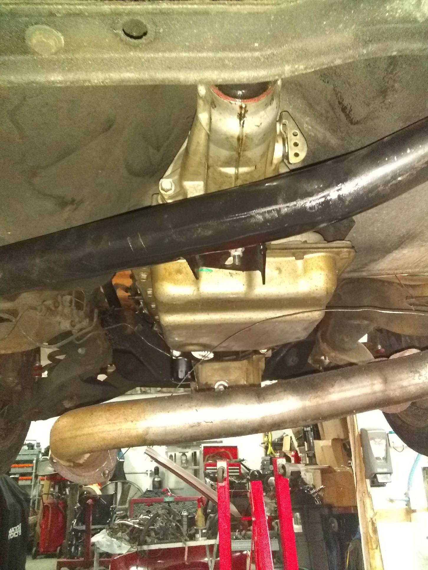

Modified the stock el Camino crossmeber to fit still waiting on the pan to get here and need to order a radiator

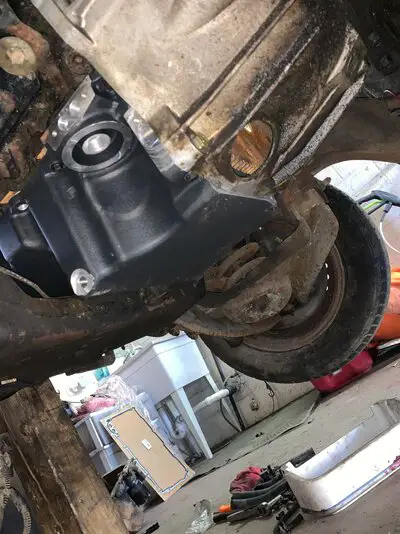

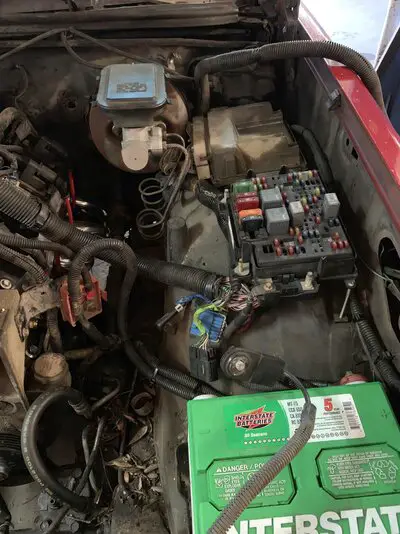

New oil pan, front clip back on just got the driveshaft back,she’s sitting a lot higher than she did with the 350 sbc, now we are starting to do the wiring we need a little help does anybody have an ignition wiring diagram or something to go off
