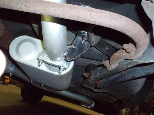

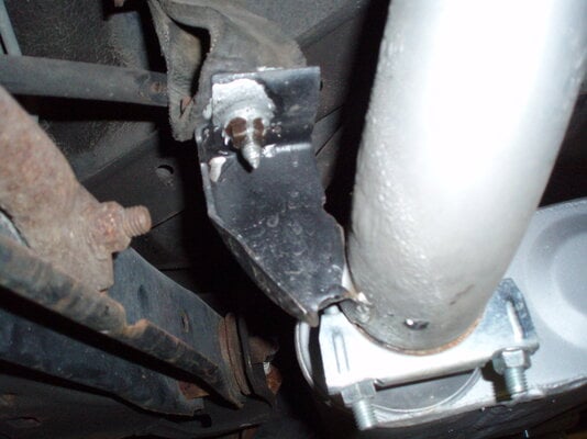

These are shots from under my 88 Monte Carlo SS. Due to running a 2.5 cat back system I ended up welding the brackets to the pipes. The bracket behind the muffler was made for 2.0 pipe and the ring that wrapped the tail pipe at the bumper was made for 2.25 pipe.
Left side at muffler and Right side at muffler.

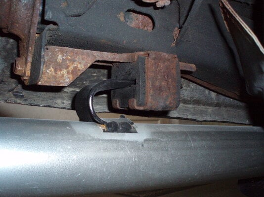

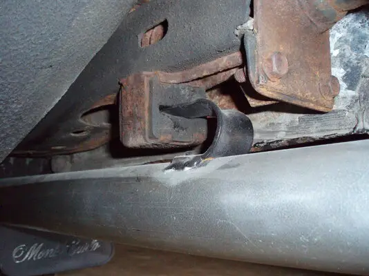

These are the tail pipe factory hanger without the strap.
Left and Right.
