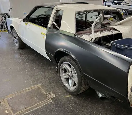

Thank you. I should probably make a build thread but I’ll just send them here. I got the car in 2018, and it’s closer to being done than not done fortunately. I got the fenders, doors etc sanded down, new quarters (1 of which was an original Chevy panel) and just need the tail panel before the cars painted. I think I found one, will post an update in a couple weeks if I get it.

What size are your rims and tires? I've been looking at chrome IROC's for my Malibu.
Actually i think they’re either 225’s or 235’s. I don’t remember the 3rd measurement. They are 17’s though

I can only find Chrome IROC's in 16's, 18's and 20's. 20's are too big. I'm thinking 16's or 18's. Leaning towards 18's for tire choice. Still need more research. It's still a down the road project.
I’d recommend the 16’s. The 17’s rub on the front sway bar, but it might just be the specific width of the repro rims. They’re not real irocs, they were made by American Racing but I don’t think they’re produced anymore unfortunately. They’re posted on summit but aren’t in stock there either
