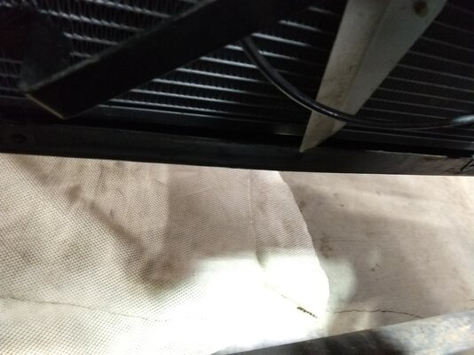

My MCSS temp is so consistently at just a hair above the 100 degree line that I tested my temp gauge and sending unit 2 years ago to make sure it was working properly. Yesterday I was sitting at a red light and I saw the needle move! It was a huge awshit moment because I knew something was bad wrong. The temp never got over 200 but I was intently watching, and waiting for it to climb higher. When I popped the hood I didn't see the problem right away. The 16 inch fan does not have a frame or a protective ring/rim for the blades. The fan had loosened, and dropped down just enough, 1/8th to 1/4 inch to make contact with the lower radiator support. I had already purchased a 16 inch replacement fan for my LS swap but will be replacing the old fan today. I'm very impressed with how well my radiator worked, with a partially or totally non working fan.

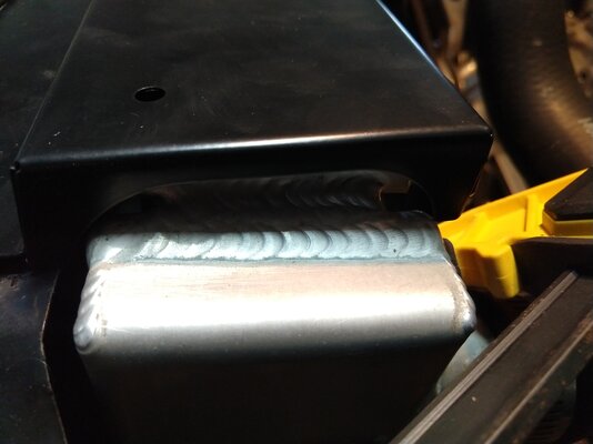

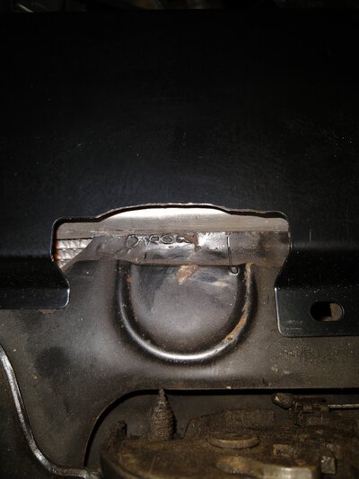

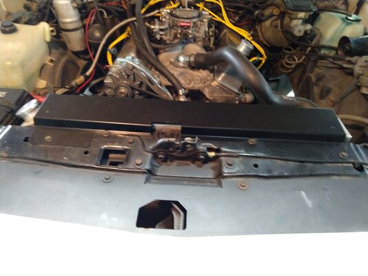

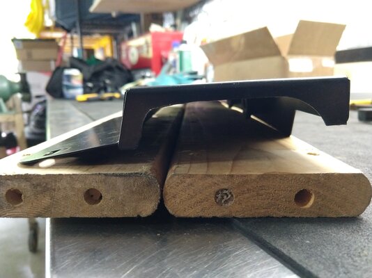

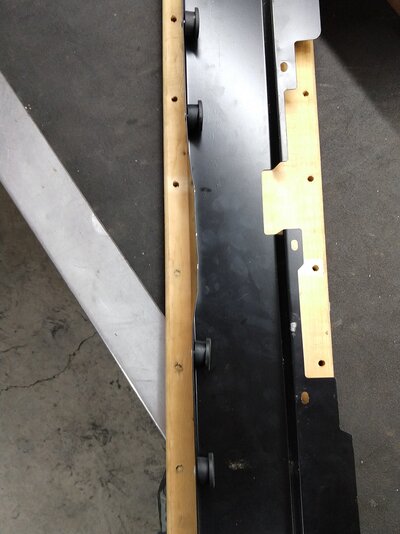

After a few adjustments I'm finally happy with my top support fitment. Tried closing the hood and the damn hood spring catches the front of the support. Can't effing win.

I bought the same top plate and had to do the same mods to keep my factory style hood spring. Only pic I can find is an oldie but still using that plate.

Drove about 150 miles yesterday and hit several rough spots. I **thought** I had my fan fixed but it slipped again. Shook loose just as I turned into my neighborhood. Damn shame. It is a nice 18 inch aluminum fan. I replaced it with an all plastic 16 inch fan with a full cover. I managed to get the new fan attached without removing the radiator. I can reach the driver side with my hand. The passenger side top I gripped the plastic lock nut with my biggest channel locks. I engineered a tool to help reach the bottom lock nuts using some masking tape, some rubber hose gaskets and a broom handle. It worked really well. I readjusted my top support so it fit even tighter than before. New fan and support look awesome.
