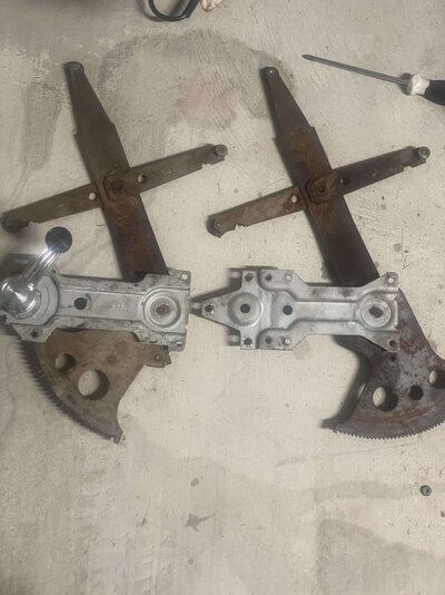

Hey do I am currently swapping from auto to manual regulators. I got to the point of hooking up my manual regulators and none of the holes to mount the regulators line up. The donor car the guy said was an 86 Pontiac Grand Prix which I thought worked with my 85 Monte Carlo but it’s seeming like it doesn’t unless I’m missing something any helped would be great
By the way pic on the left is passenger manual regulator and right driver side auto regulator.
Thanks in advance.

This might help, notice the electric regulator mounts horizontally with the four rivet holes, the manual regulator mounts on a 45 degree angle with it's four rivet holes. See the pics in the article.
Good luck.

Man thanks a bunch this helped me out ALOTT. I will knock it out this evening.
