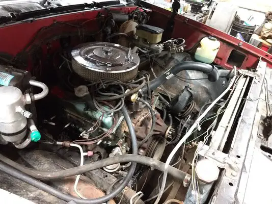

Quite a few things under the hood were left disconnected after being tampered with, as the engine has supposedly been rebuilt and the transmission definitely got replaced at some time- actual mileage or specs on these is unknown. She's equipped with ESC but the knock sensor wire is cut/missing and the "tip in" vacuum switch is plugged, which jives with the replacement th350 transmission not needing it to control converter lockup. The ESC module is still wired (not bypassed) and provides spark but no ignition retard as it never thinks it needs to.

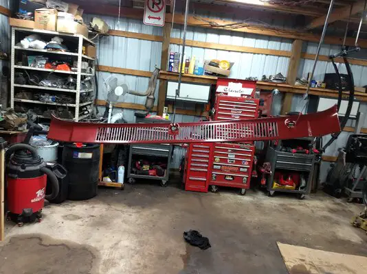

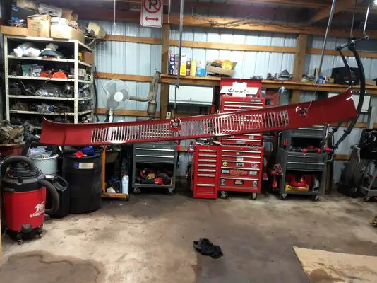

I scraped the sealer from the cowl area, replaced it, and painted everything again after:

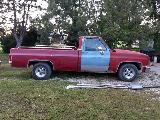

In addition to cutting the exhaust off from the muffler back I also removed the rear bumper, which required an impact, a grinder, and a mini sledge.IMG_20250422_201018496~2.jpg

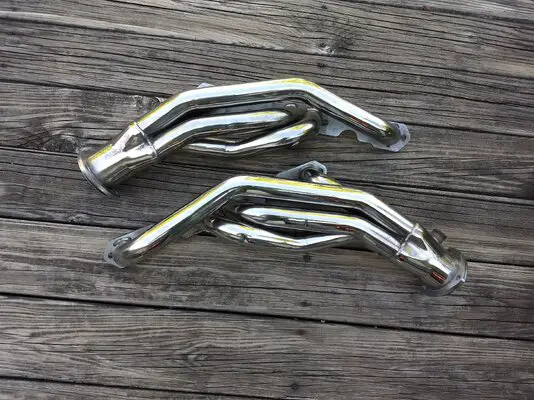

The headers are as polished as I'm going to get them, though a bit more time would definitely garner results. My arm is tired:

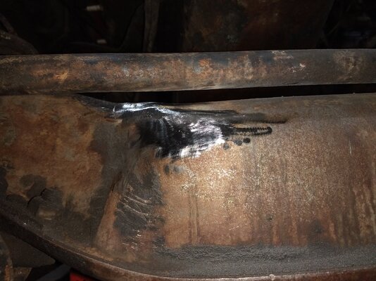

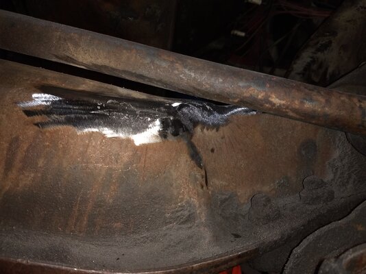

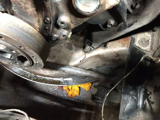

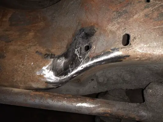

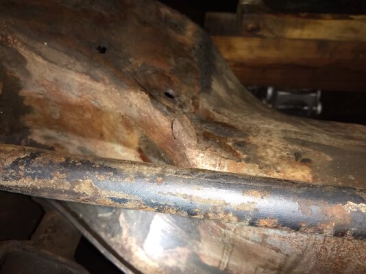

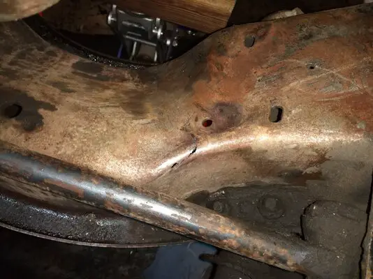

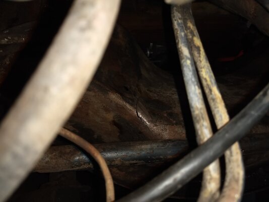

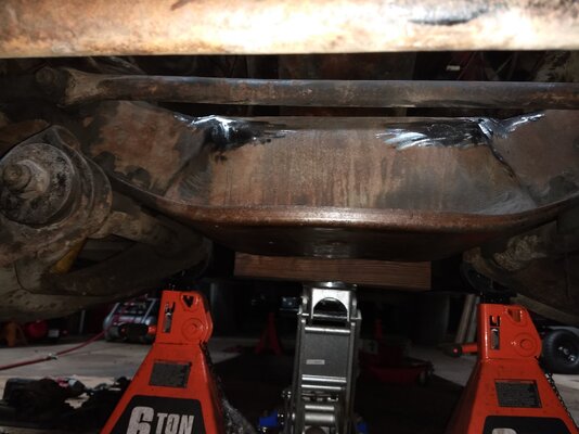

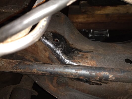

Then I found these:
So after drilling a couple holes I grabbed my little Lincoln flux core welder and cranked it up to "D", set the wire speed at a modest "5", and went to work. A little time with the die grinder wearing a Roloc got me to here, and I'm not quite done. You can clearly see the edges of the weld but the cracks are completely filled:

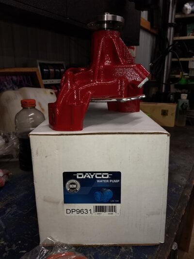

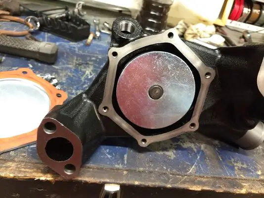

I also finished cleaning and painting the serpentine brackets, pullies, etc., though that involved a bit of repair where the compressor bolts live- corrosion had mated the compressor to the bracket and two pieces broke off once they were separated. No pictures of that at the moment but you can see the reverse rotation water pump:
