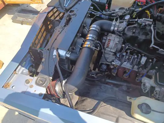

I have 01 3/4 ton pickup accessories that fit fine, and the engine sits up high enough that a truck pan cleared the crossmember. I run a small case lower amp output alternator off a base model 06 sierra and a little hood trimming (a GP hood is the worst for clearance anyways).

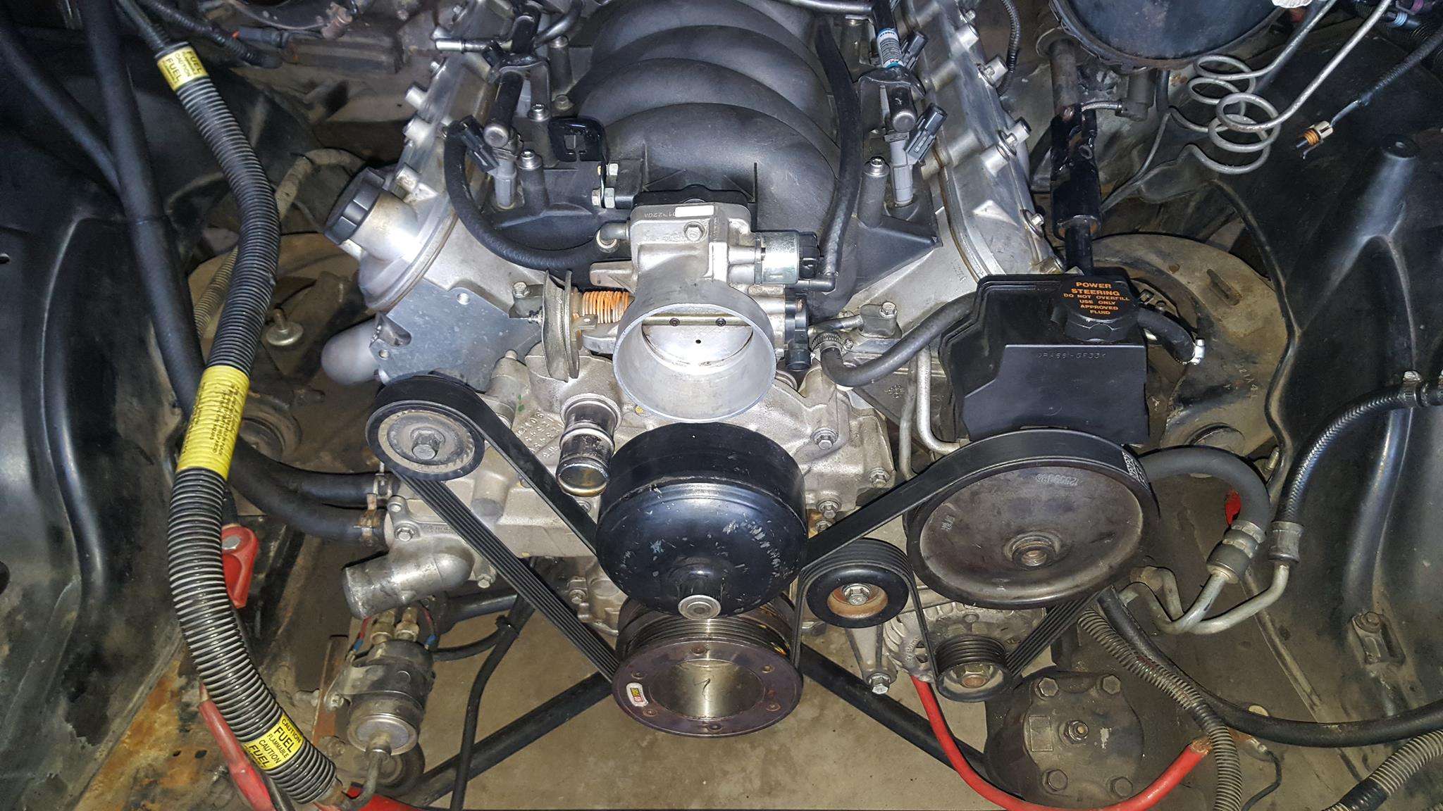

Truck accessory with ls1 f-body water pump (req. spacers) and holley g-body specific engine mounts. I have always been sensitive to function, and not aesthetics beyond a straight body (on women and cars). In other words, I don't see the "ugly" in the truck accessory bracket or the truck intake or what some of you might call a 2-bagger.

How far back is your engine set back? I've been thinking of switching to F-body style but keeping truck spacing. Mine is practically hitting the firewall. I feel like maybe able to clean the alt on the steering box since my truck PS pump clears with the big pulley.
Non Setback mounts
