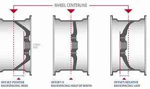

I'm going for a 70's street machine look I want a mean stanceUnless you are going for air shocks and rims sticking out of the wheel wells a -44 offset on a 10" will not work that will be about 6.75" off the drum pushed outwards, but at least it wouldn't require a frame notch.
15" x 8" with 3.75"- 4" BS or close to 0 to + 6 offset usually work best on stock set ups
