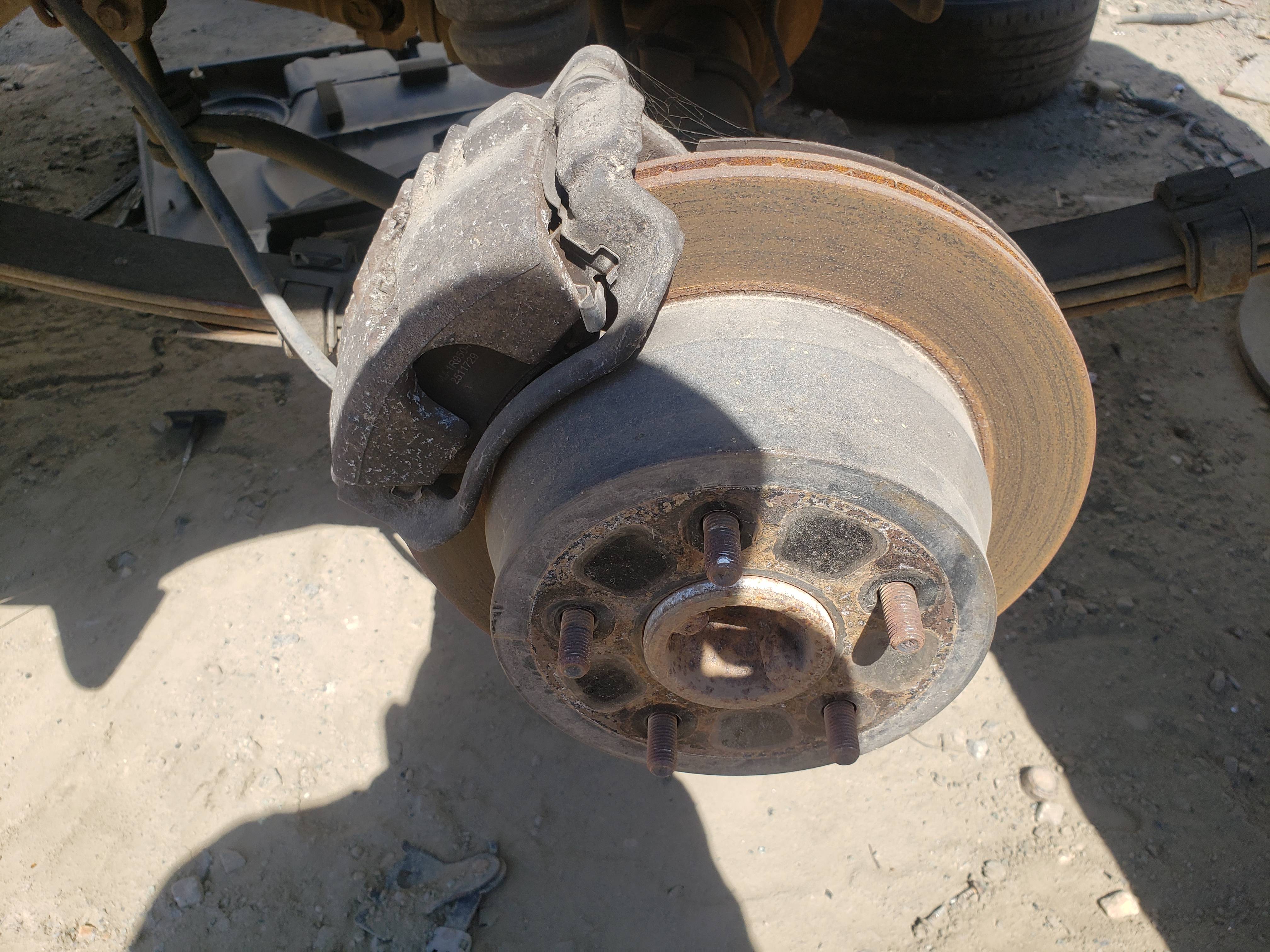

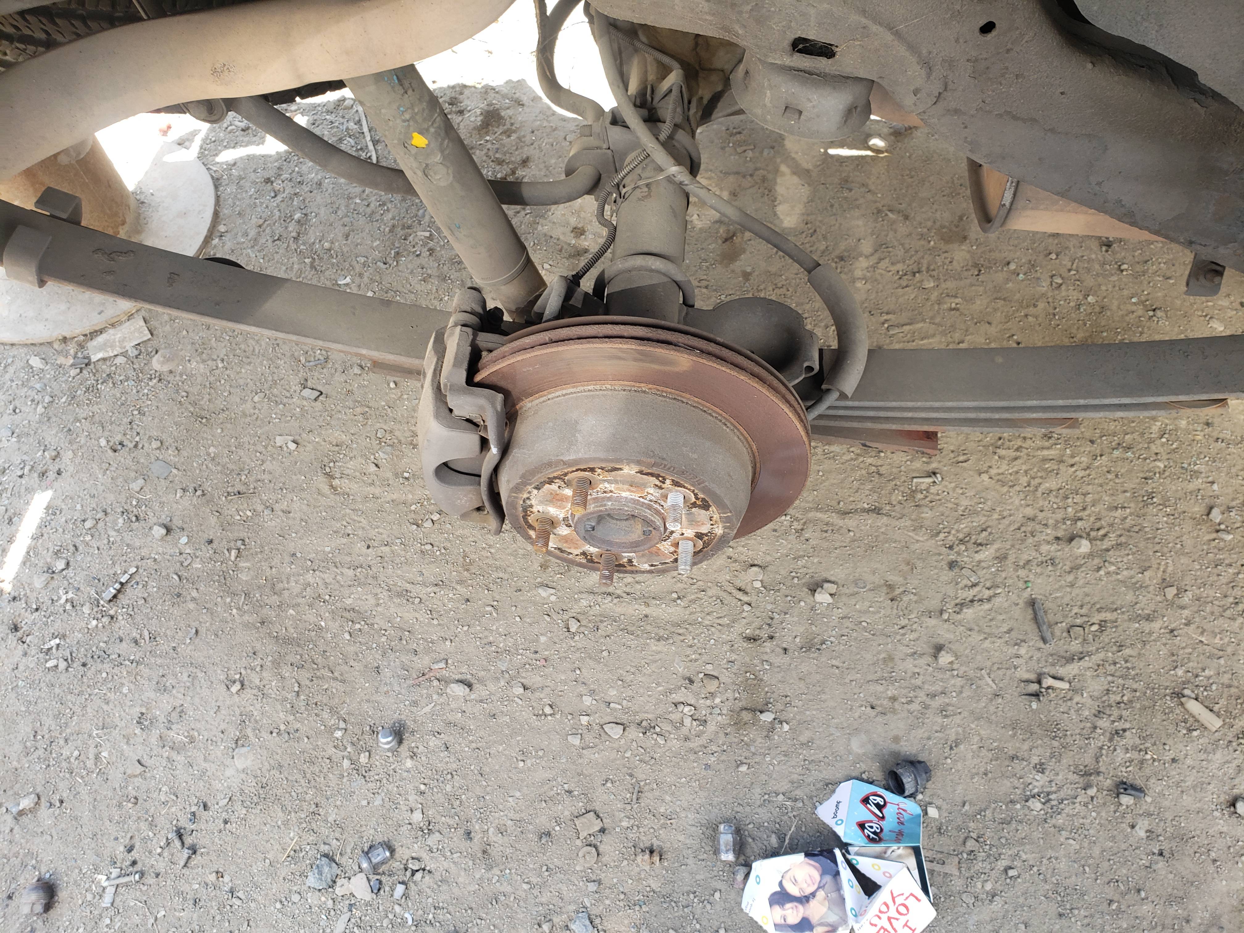

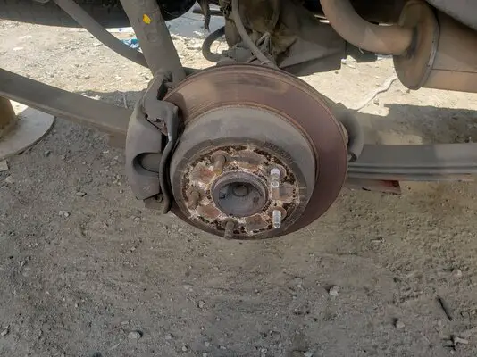

I haven't got a answer yet but I went to the local junk yard and got a camaro 36mm sway bar to put in my monte. While I was there I saw a blazer and noticed the disk brakes were in the back position of the wheel instead of in front im guessing it was a 2w drive it seems like this is what might be what I need since my car is lowered im waiting to get a answer before pulling these parts.

You want the 2 wheel drive Blazer set up with the calipers to the rear. You will need to make a lower bracket to move the bottom attachment point of the shock absorbers inward to clear the calipers.

They shouldn't with the calipers mounted to the rear as they are on the Blazer. You will have to make a bracket to relocate the lower shock mounting point in towards the center to clear the calipers. I do not think you will be able to use the Blazer brake hard lines. I made new hard lines on mine to attache to the original brake hose.
