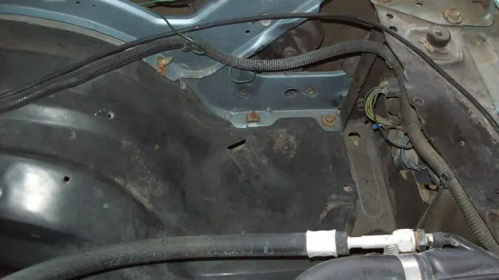

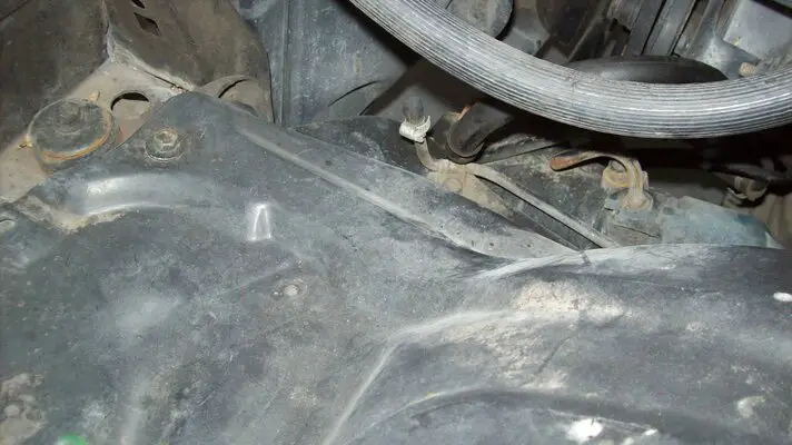

Not that i smell any gas fumes under the hood or by the gas tank, engine idleing or not, its inside the car i smell thats like a combination of gas and exhaust when taking a cruise anywhere, its not overwhelming, but it needs to be delt with.
Here is how i recieved the car, the prior owner(s) removed the charcoal canister and its associated hardware, all thats left is the gas tank vent line secured to the frame that has a deteriated rubber vacuum plug on it, good for keeping the bugs out, thats for sure.

If you smell any kind of gassy smell however diluted then you do need to slither under your ride and inspect that vent line all the way from the tank to the canister location. Start by replacing that dead plug that was installed to cork off the line when the canister was deleted. if that doesn't solve the problem then the line itself could be rotten or possibly the hose at the tank end has split or broken and the tank is venting direct to the environment. Should the tank hose be damaged, you would not get much of the smell because most of it is behind you and left behind when you drive. You'd get some of it at idle due mostly to whatever breezes are blowing around.
