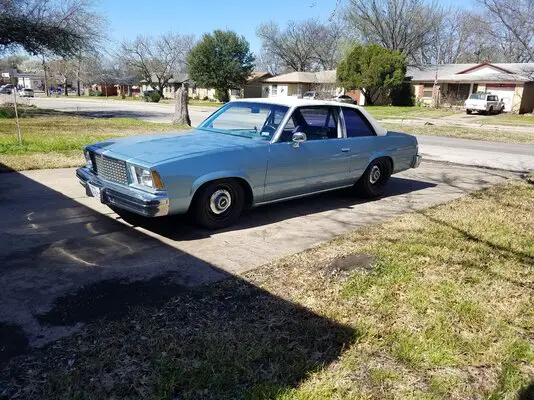

15x6 steelies up front (195/65-15 @ ~25"); 8" wide in the rear. Same BS I've used for the skinnier steel Ralleys (GM car & truck) as well (3.75"BS). I always try to match the tire section width to the wheel sizes front & rear for visual consistency (I dislike a 'pinched' tire @ one end & a 'stretched' tire on the opposite end). I still have the damaged inner wells but my car is lower.

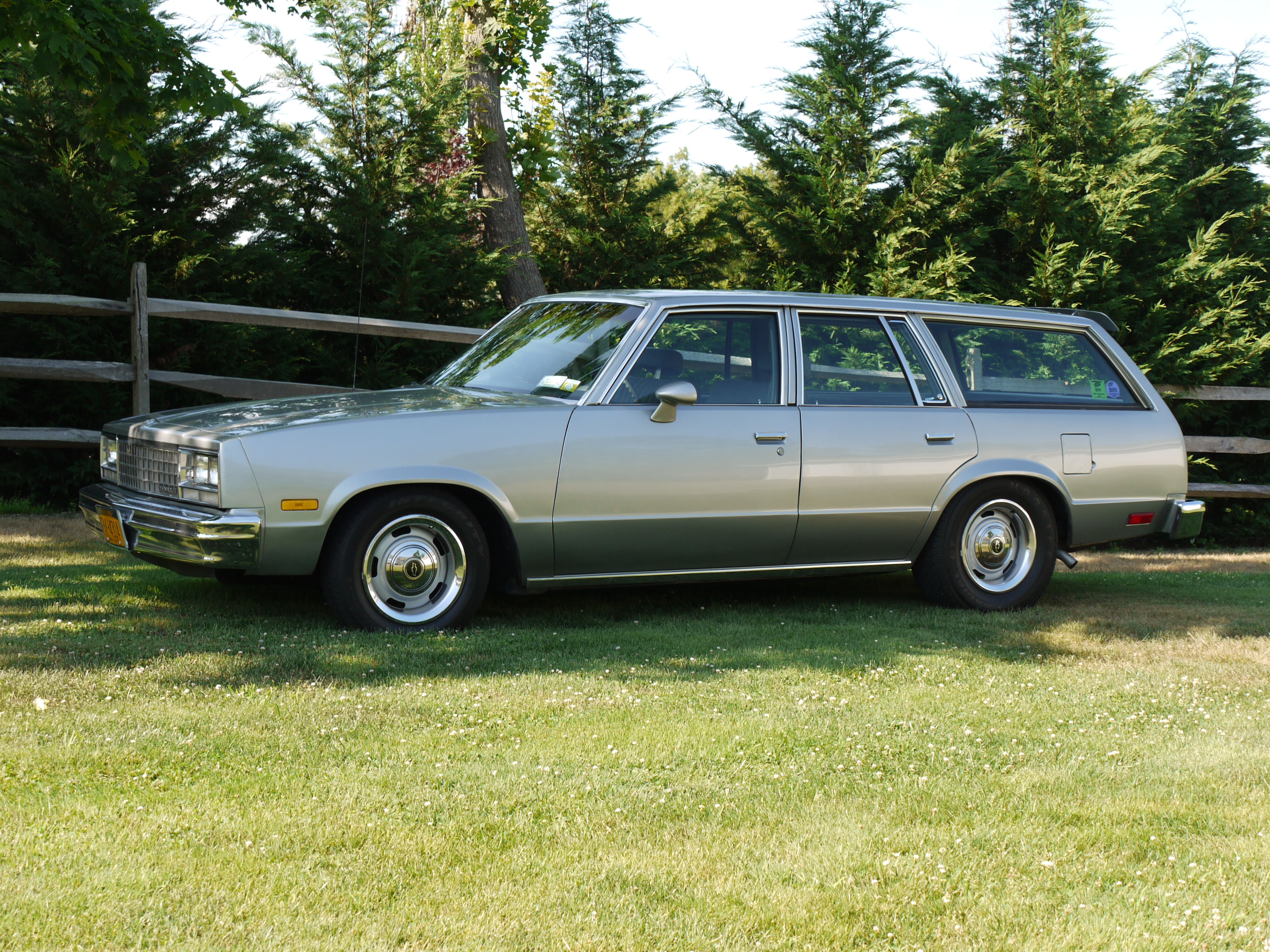

This is how the car looked before I redid it. The tires are toast. The Hoosiers on the back have pretty large cracks in the sidewalls. Fronts are Goodyears and theyre rock hard. The spare was a Uniroyal and it might be the original. That one was rock hard too.
Since the cars basically the same color I was thinking about spraying the rims a darker grey and changing the center caps to the disc brake style. I had some base coat left from the firewall so I sprayed one of the fronts to see how it looked and it needs some contrast. Rally wheel argent doesnt look much better.
My only concern if how the 6" rims will fit. Looks like theres no issues so I'll have to find a pair.

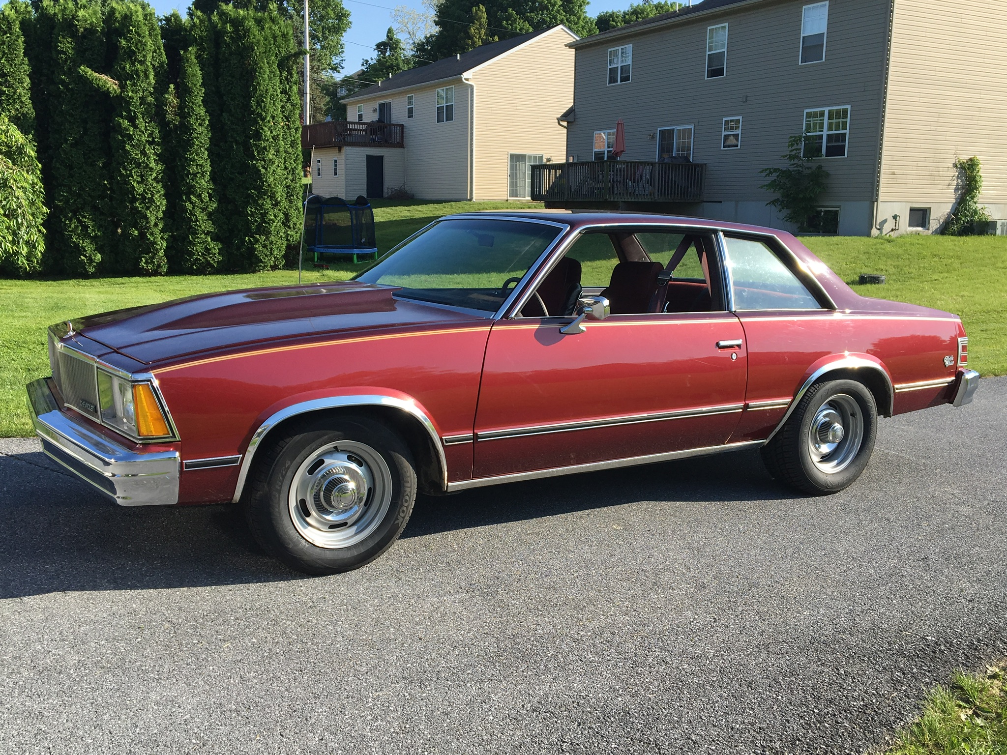

I've used the Duplicolor Gunmetal/Graphite wheel paint before and love it.
It's definitely darker than the ralley wheel gray but it's awesome and has a lot of small metallic in it.
Here's my old 83 wagon, original Light Fern Gray paint. I painted the N90s with the Duplicolor. Gives you an idea of the color combo.
