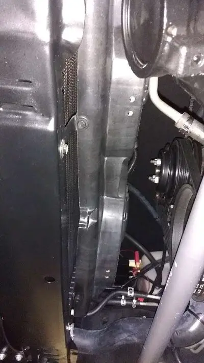

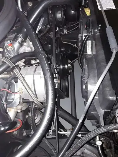

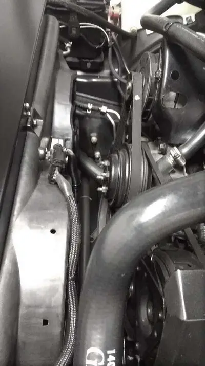

I'm using the Chrysler Sebring fans on the original HD radiator. The fans shroud fits perfectly end to end as well as height thus sealing well against the radiator. Keeps me at 190 even at 100 outside temp here in TX.

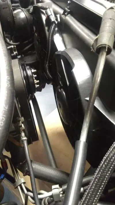

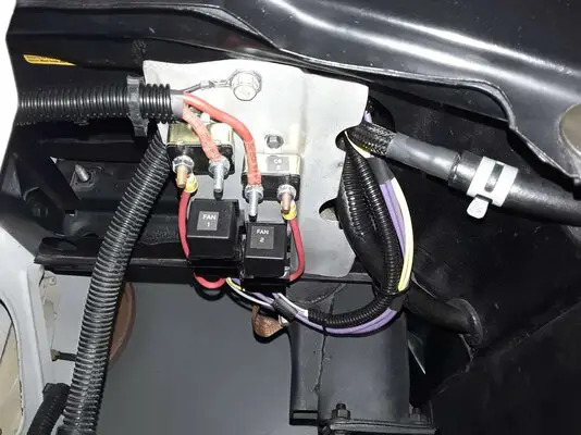

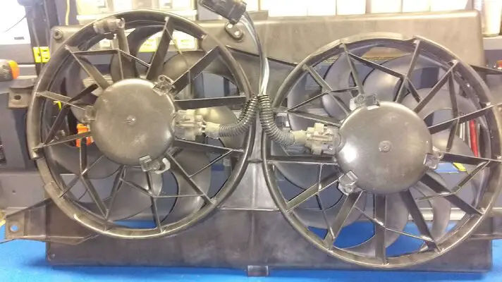

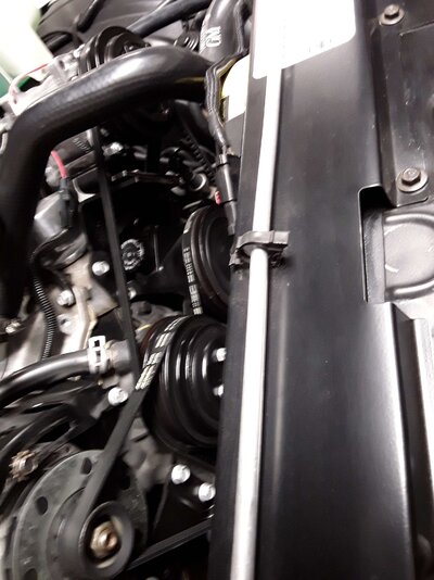

It is a perfect fit both size wise and depth. There is plenty of room between the fans and the engine accy belts. Wiring kit with wires, relays and 30-amp CB are online everywhere. I used the space between the lights and the battery (wall) to secure the plate I made for the relays. Used the factory lower mounting holes to hold the fans in place. The upper metal cover I got on-line.
