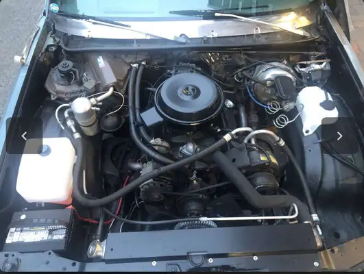

Do you have the Thermac aircleaner hooked up?
ck80
Moderator
Moderator
Feb 18, 2014
5,587
8,741
Looking back, he had a single pic above that looks like a modified or aftermarket air cleaner posted above. The neck is short and smooth, doesn't show the normal bump for the thermostatic vacuum unit on the snorkle, nor does it show a heat stove pipe glinting underneath.
Dezimade -
Basic pieces would be a heat stove on the snorkle side exhaust manifold - basically a shaped piece of tin work with a circular opening on the top; the pipe which by gbody years was usually alexible alum tube with a clamp on either end connecting the heat stove to the snorkle, then on the air cleaner snorkle you had a temp senor and some vacuum lines, looked like a small round puck on the air cleaner snorkle. Inside the snorkle neck you had a metal flapper. It was the job of the sensor to adjust the door so below mid 80s *F air charge temp the door closed off so air only came from the stove to carb. Then in the lower 100s it opened partway to blend the air, finally in the 130s or 40s air charge temp it would open to pull air from the end of the snorkle tube and close off the heat stove source.
Different models had different locations for some of the stuff, but, in the gbody era that was generally the set up.
Dezimade -
