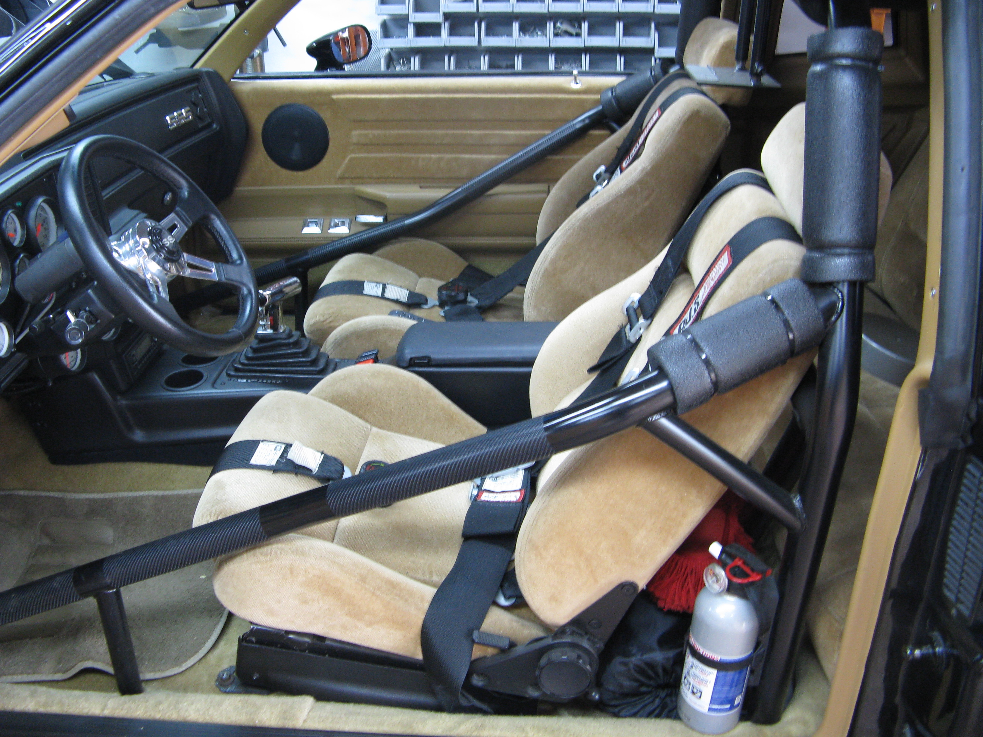

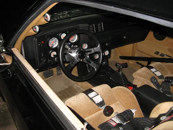

I have the Fbody console IMO it doesn't look out of place in a Gbody and they have enough aftermarket support to have shifters dedicated to fit this console without modifications.

565bbchevy, I really like your interior. Every time I see it I'm impressed. Nice work and yes the Fbody console looks like a great fit.

Your car is one of the ones that got me looking & considering them. That being said, the black color helps hide some differences that stand out if a lighter color is used. Mine is the light blue. I cut the front section off of a bad console & put it under my dash to see how it looked. I thought it would look as good as yours but I wasn't feeling it w/the lighter colors.
