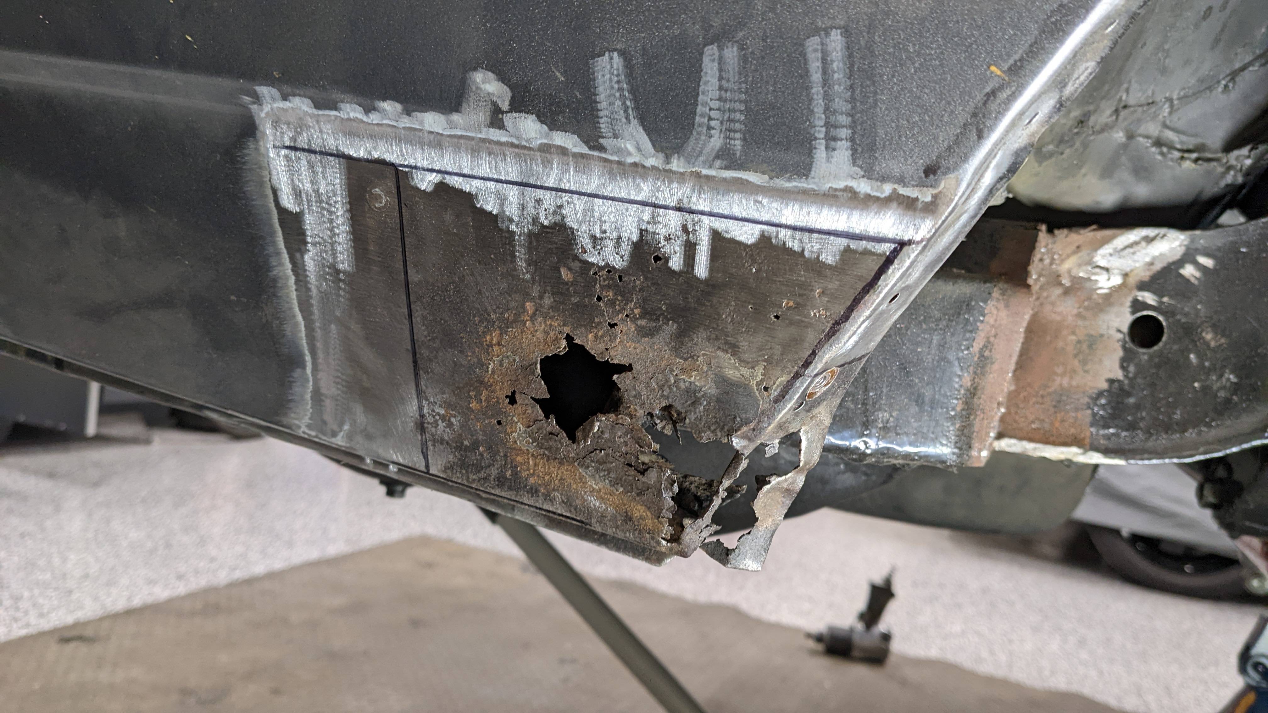

You can kind of see it here - after grinding, running the TIG torch over the welded area really smooths things out.
Fit-up, not sh*t-up. Surprisingly.

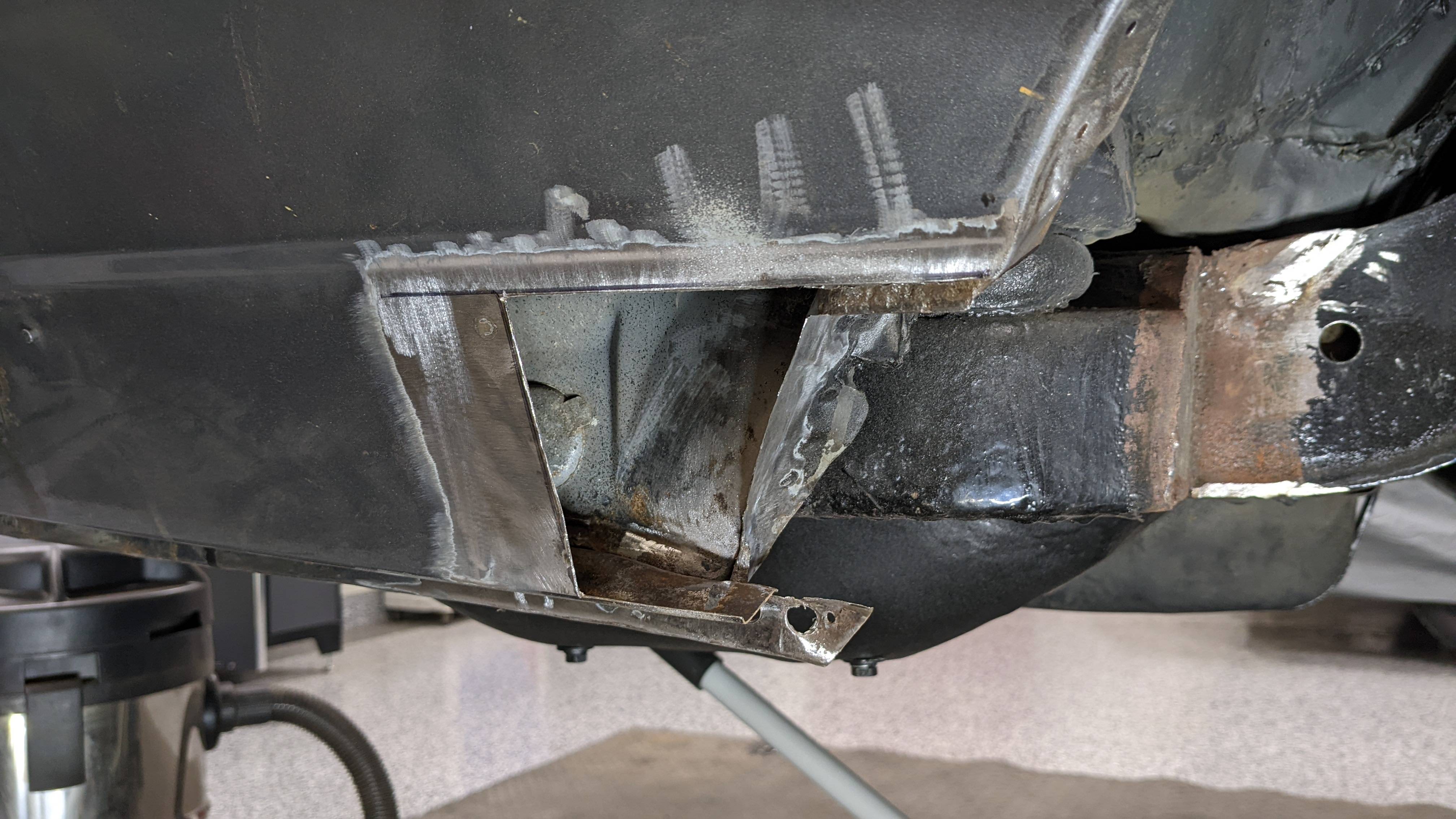

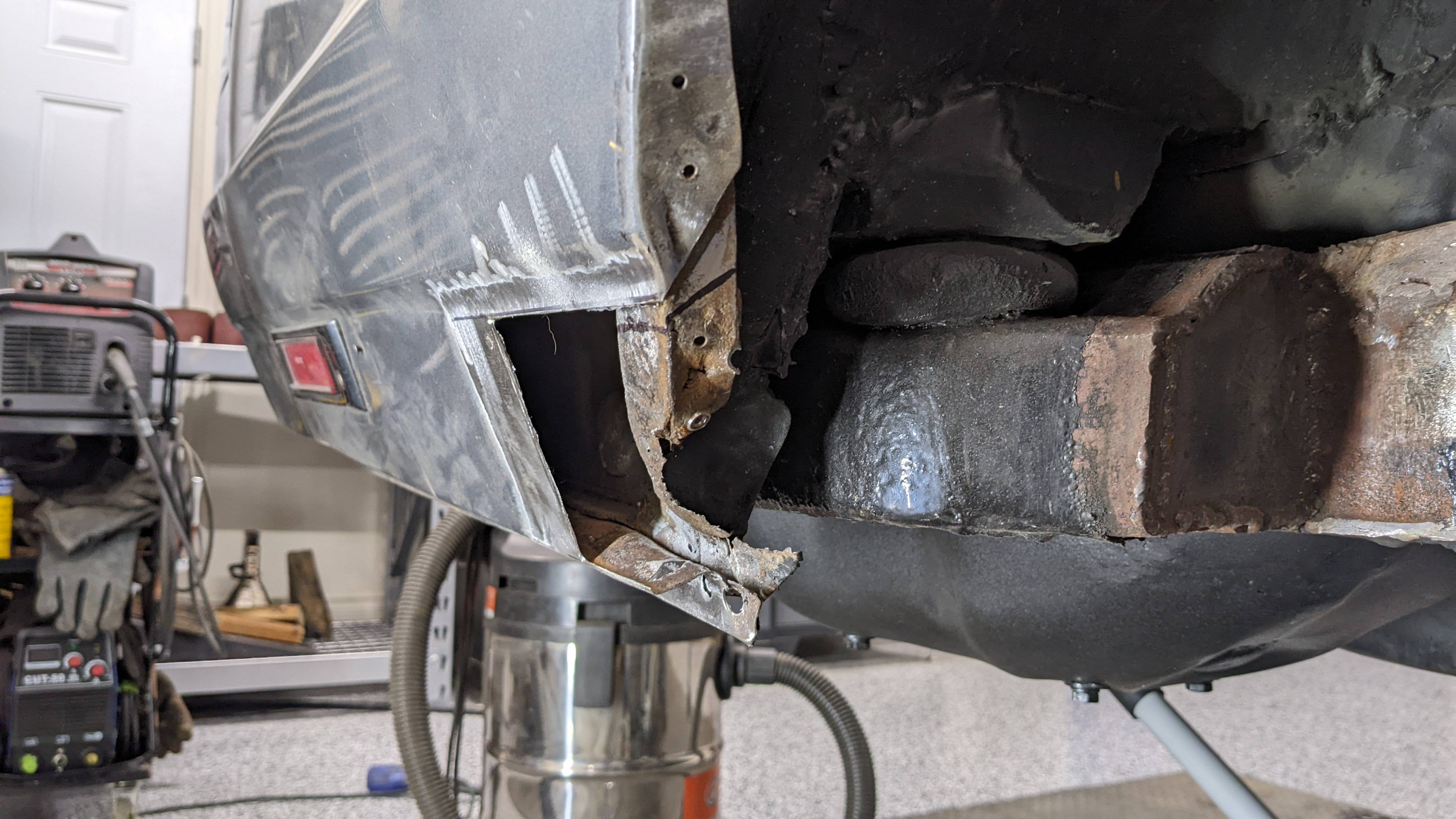

Thanks to the driver's side quarter being complete and undisturbed it shows that the bottom of the fender lip is only folded over not formed or welded. Modern cars have much more advanced tooling that make for more complex stampings. How times change. Tossed some rust converter on, shot some primer and got to burning it in.
With that all done. And some crying. It was time to assess the PS front lower which is pock-marked like Whoop Goldberg's @ss.
The lines look high, and the amount to be removed looks excessive, but - if the rear was any indication there were some surprises waiting. Plus, the rust on the inside can be seen through the belt retractor recess. Spot-welds, so many spot-welds.
More.
And more. Somebody should fix that hole in the floor...
Yup. Surprises. No, your rust free G-body isn't.
I was able to pop it off it one complete piece. Will make a great template.
I cleaned the surfaces off, made a plan, tidied up the tools, swept the floor, and called it a day.
I am trying to balance the depth of repairs against the level of invasiveness/effort needed to get a good result. I could go much deeper, but at that point it is headed toward a rotisserie and an all-in approach. I'd rather work on a rolling restoration. With any luck this will hold up for another couple of decades in a pampered environment.
Reactions: 9 users
