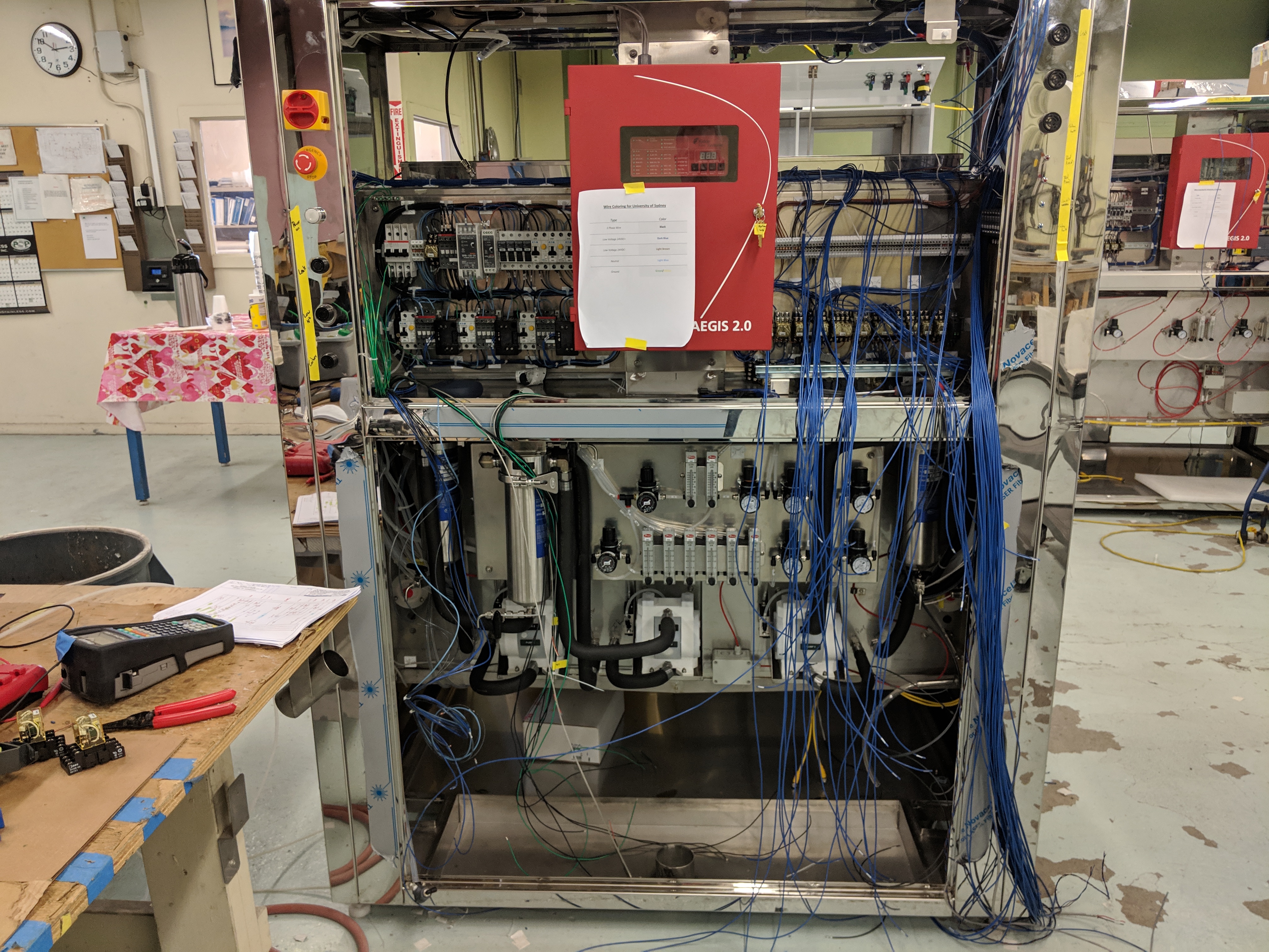

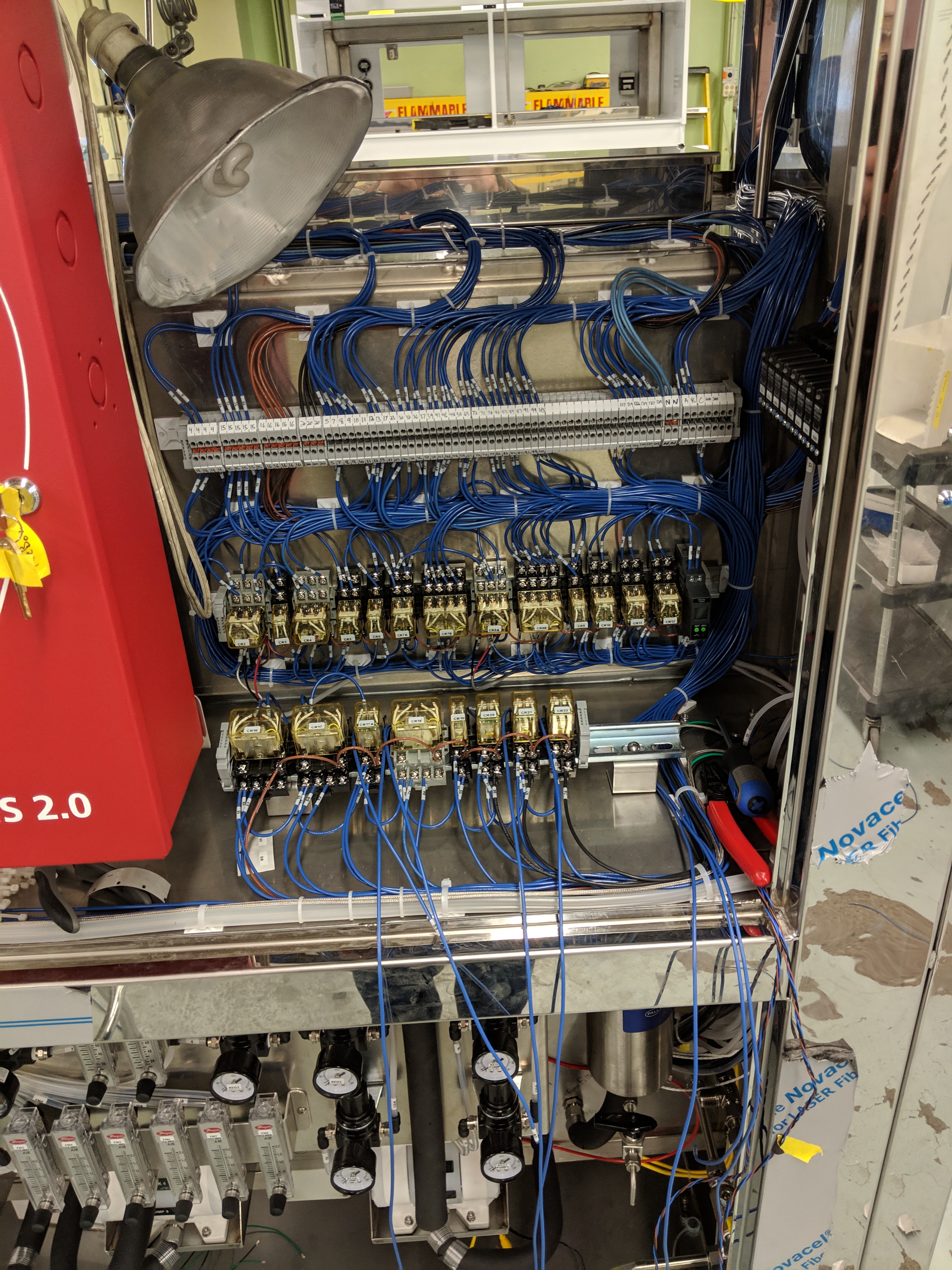

I feel your pain. I do it for a living... Here's a project I've been on for a little while now.
img_20190306_145110-jpg.108042
img_20190308_152920-jpg.108043

fleming442
fleming442
Dec 26, 2013
5,096
5,437
View attachment 108042 View attachment 108043
GAAAAAAAH!!!! THEY'RE ALL THE SAME COLOR!!!!!
That's the stuff nightmares are made of!
Mike, lanolin hand cleaner is great for cleaning up the insulation. There's not much worse than electrical tape goo stuck to your fingers.
