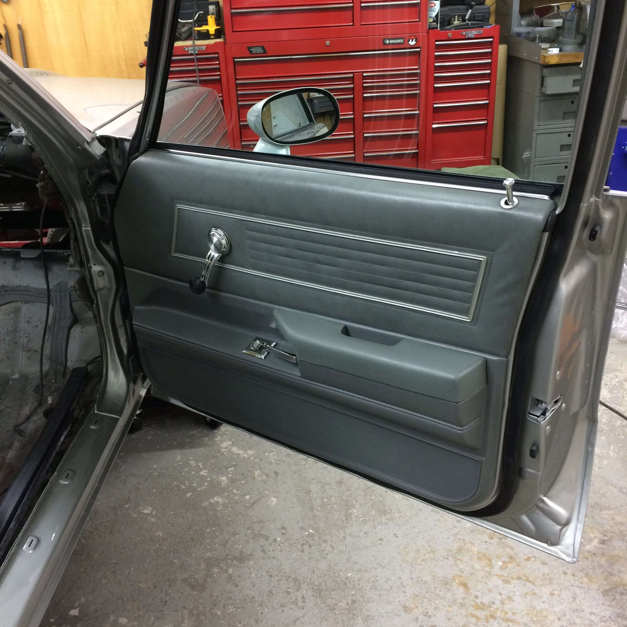

Fern Gray is a greenish gray. It was the original color of the interior in my 83 Malibu wagon. It was also the color of the body. Its a metameric color. Changes shades under different lighting. When my car was in the shop they used the cowl tag to get the right color. When they sprayed the jambs the first time it came out a very light green instead of the silver/gray. They even tried to scan the original hood and that didnt work. In the end they used a Nissan color from the early 90s.
This is the original front door panel. The dash was slightly darker.

That is really awesome 69hurstolds you’re the man!
Looks pretty similar to ours minus 40 years of cigarette smoke.
looks similar to ours minus 40 years of cigarette smoke 💨
