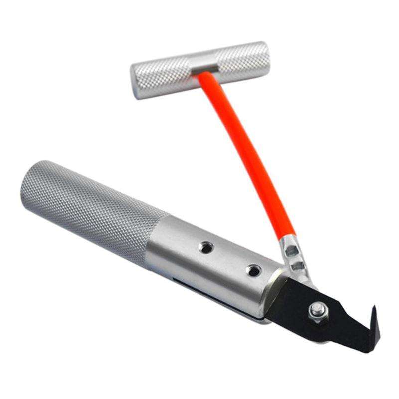

Since the windshield is junk they might use a speed knife to get it out. If you are trying to salvage a good windshield to reuse you have to use a wire to cut it out. There are also power tools and hot knifes they could use but the dash is not in danger.
Agree with above and add it might be beneficial to remove it so you can check for rust or paint damage. Or to add rust inhibiter or paint before the new windshield is installed.
Speed knife is only good for the old cars with the butyl tar crap holding it in. It will break a windshield when pulling it out so do not use it to salvage good glass. It will work fine on all tempered glass like back windows without breaking them. This is useless on modern cars with the hard plastic install, you need a hot knife for that. This is the cheapest way for the average person to remove an older design windshield.

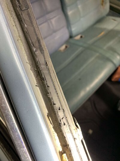

Okay guys I sort of veered off the plan. Gonna rain all weekend so I decided to pull the windshield my self, and it's out now. Used a utility knife and it wasn't too bad.
So now I am left with black sealant all the way around where the windshield was. I would like to do some prep for the new glass since I'm in this far.
Do I just start picking away at the sealant, say with a utility knife? Or is there some other way. And how meticulous do i need to get with the prep work??
