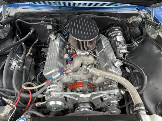

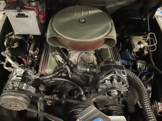

I agree with CK80. I think your fuel pressure is too high and might be causing flooding in the carb or blockage in the return line. I once had the same carb with an inline fuel filter which wasn’t sealed properly. If it was hot and I shut the engine off for about 10 minutes the carb would flood. The only way to get it started was hold the accelerator to the floor. Next time you have the issue (road room permitted) floor it. If it keeps running you‘re flooding the carb. As a reference I once had a 396 bored .20 over, big cam with an a Edelbrock double pump, I set my fuel regulator to 7.5psi; it ran great! Never stalled or bogged. The engine with Blue is the 396 with a Holley now. The engine with the Green is the same carb. That inline fuel filter is the one I had to seal; it screwed together.
