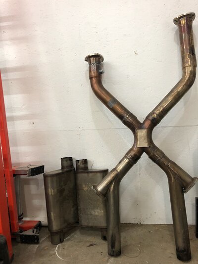

I made a cutout after my x- pipe going into a 3.5" ovaled single exit piped into a drivers side exit in front of the rear wheel. Cable operated for instant on & off. I feel that a length of pipe gives better sound quality rather than dumping under floor, some late models adjust through exhaust.
Though a good setup can increase power, I call it mostly for fun & for adjustability. Loud is especially fun with a stick shift revved up in low gear on both accel & deceleration. Loud as hell is cool, but not all the time. Being able to open exhaust under an underpass or tunnel & rev it up, then going back to legal sounding is the best of both worlds.
My setup has been broke for a while & debating what my next exhaust will be, but just like a good equalizer on a stereo, it's good to have some adjustable control.
