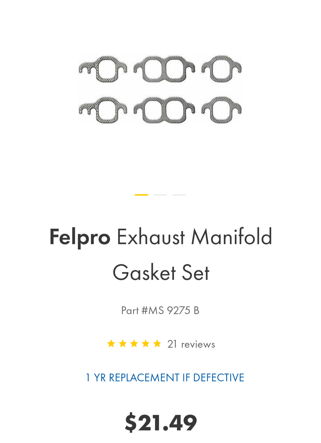

And the only gaskets I can find locally with a seventh hole are these...
Those gaskets should work fine. Make sure you clean both the head surface and the manifold surfaces before installing. My Dad taught me a trick used back in the 50's & 60's that I still use today with stock manifolds and that is to put a thin smear of anti seize or even wheel bearing grease on the mating surfaces or if using gaskets very lightly coat the gaskets then install them. I've never has a failure with stock manifolds and I normally run them without the gaskets.
