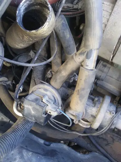

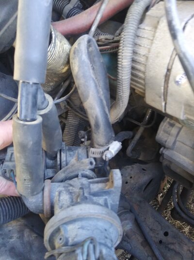

Had to take a power nap. But when I got out I found the pump. . . the system is loose from it's bolts and hanging off the passenger side close to the Engine. Check out this Jury Rigging the owner previous to the owners I bought the car from did.
At this point I am going to have to wait for my Chiltons Repair Book to come in before I can sort this mess out. Not sure what goes to what here. From the looks of it I am going to have to redo the pump system here connect everything back to where it needs to be get a new Fuel filter with it's casing, new hoses etc. No getting this started for awhile Water and cleaner for the coolant is going to sit for a time too.
