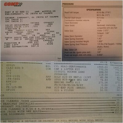

Ok I'm at a mid-way point with my project now. I picked up my freshly built, Olds 358 from the shop the other day. I would like advice, on what stall should I run with my cam, and transmission. I still would like to drive it comfortably as a daily driver, and have lots of fun in it, as well. I have Edelbrock Performer Heads, and I want to keep the 200-4R transmission. I would like to be able to cruise comfortable at 60-80 mph.

Can you give us a little more build info? What size can is installed? What intake and carb or efi do you plan on using? What is your current rear gear ratio and do you plan on changing it?
Shooting from the hip here....I would say nothing larger than 2500 stall. With the overdrive it would help, but you always wanna make sure that all the parts compliment each other so you can achieve your end goal.

Post your cam specs. That is a direct correlation with stall speed. Figure out if you are going to use a lockup or non lockup converter, and look in to getting the 2004r rebuilt and upgraded. That olds 350 can make quick work of it. What do you plan on doing with gears in the rear? With the 4s on it 3.73s would be a nice highway gear with the overdrive and still have good take off.

I already have 3.73 gears and the shop mechanic said the motor was bored over 0.030, and was now a 358. I'm getting the tray built with a super servo, and billed drums, just have to come up with extra cash. Haven't made my mind of about the 4s. I do like the way the 22s sit on there. Think I may find some 22s that fit better. Thanks for your advice I appreciate you taking the time. All of you. I want a lock up converter.

You would be safe running a lock up converter with a 2500 up to 3000rpm stall. That cam has a nice powerband so what I recommended should fit nicely into your build. I'm sure others will chime in as well.
