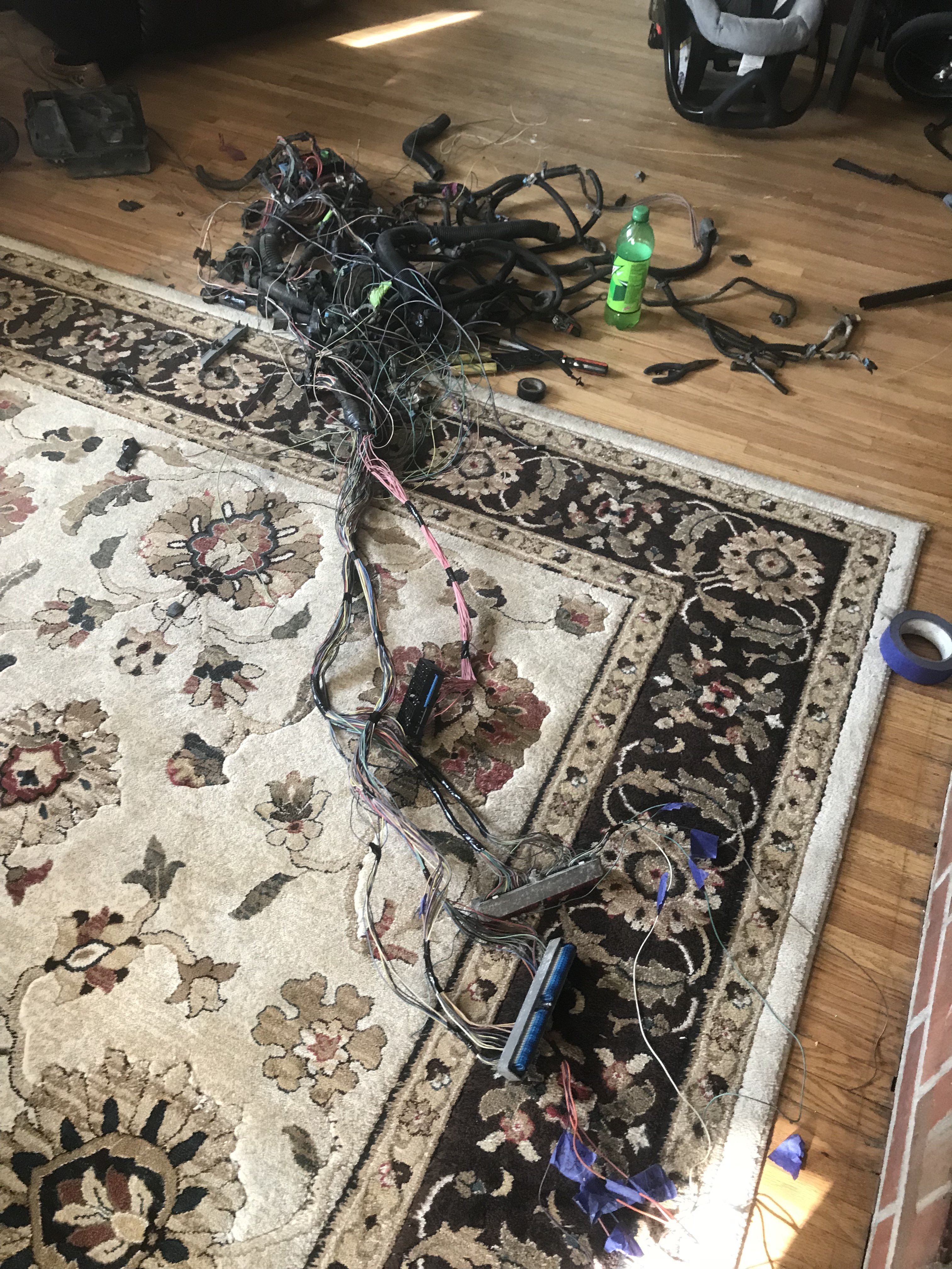

Also got on lt1swap.com to figure out the harness for stand-alone. Super intimidating at first, but with vigorous reading the instructions made me feel like I actually knew what I was doing... any advice where to send the computer for flashing?
