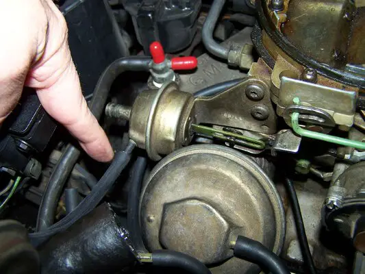

I attached a long hose to this port of the pull-off.....I sucked on the end of the hose, but did not get any movement. Does this confirm a bad diaphragm tank?
Normal. There's likely a ported hole in it keeping you from sucking that in the way you're doing it. Regardless, it's a 99.999% chance it doesn't have anything to do with your issue. There's a primary pulloff on the front which is much more influential. Remove the rubber hose and draw a vacuum on it. If it moves and forces the primary choke plate open, it's ok. But if it doesn't move with vacuum applied, it's toast. I'd also run through the linkage cleaning and operation again to make sure something isn't hanging up.

The front diaphragm can have a delay and the rear one is certain to, keep that in mind it might not be all or nothing when you put vacuum to them.
I would pull that red vacuum cap in the background of your pic and use it to test. Make sure the engine is warm enough the vacuum leak will not kill it. Put your finger over it to test it. Might have to watch the vacuum cannisters as it warms up to see total movement.

The factory front vacuum pulloff on Montes do not appear to have a delay port on them. I know for sure Oldsmobile 307s don't. So when you apply vacuum it should go. Besides, when the engine starts cold, it MUST move to pull the choke open slightly from full shut, approx. 1/8 inch or so.
Again, that rear vacuum break you've got in your picture is a waste of time. It doesn't have anything to do with your issue.
Is your carb a 17087129 carburetor? I was under the assumption that they didn't even use a secondary pulloff for 87-88. In fact, there's no replacement part number in the parts information for secondary pulloffs for 88 monte ss carb. I'm thinking someone's messed around with your carb. I see screws on your choke cover where there should be rivets.
Check the number on your carb. Driver side rear. There's a pad with some numbers stamped sideways on it. Take a pic or tell us if that number is on it. Because if it isn't a 7129, you've got a different carb on that puppy. I's actually an 87 part number, but they carried over the same carb from 87 to 88.
