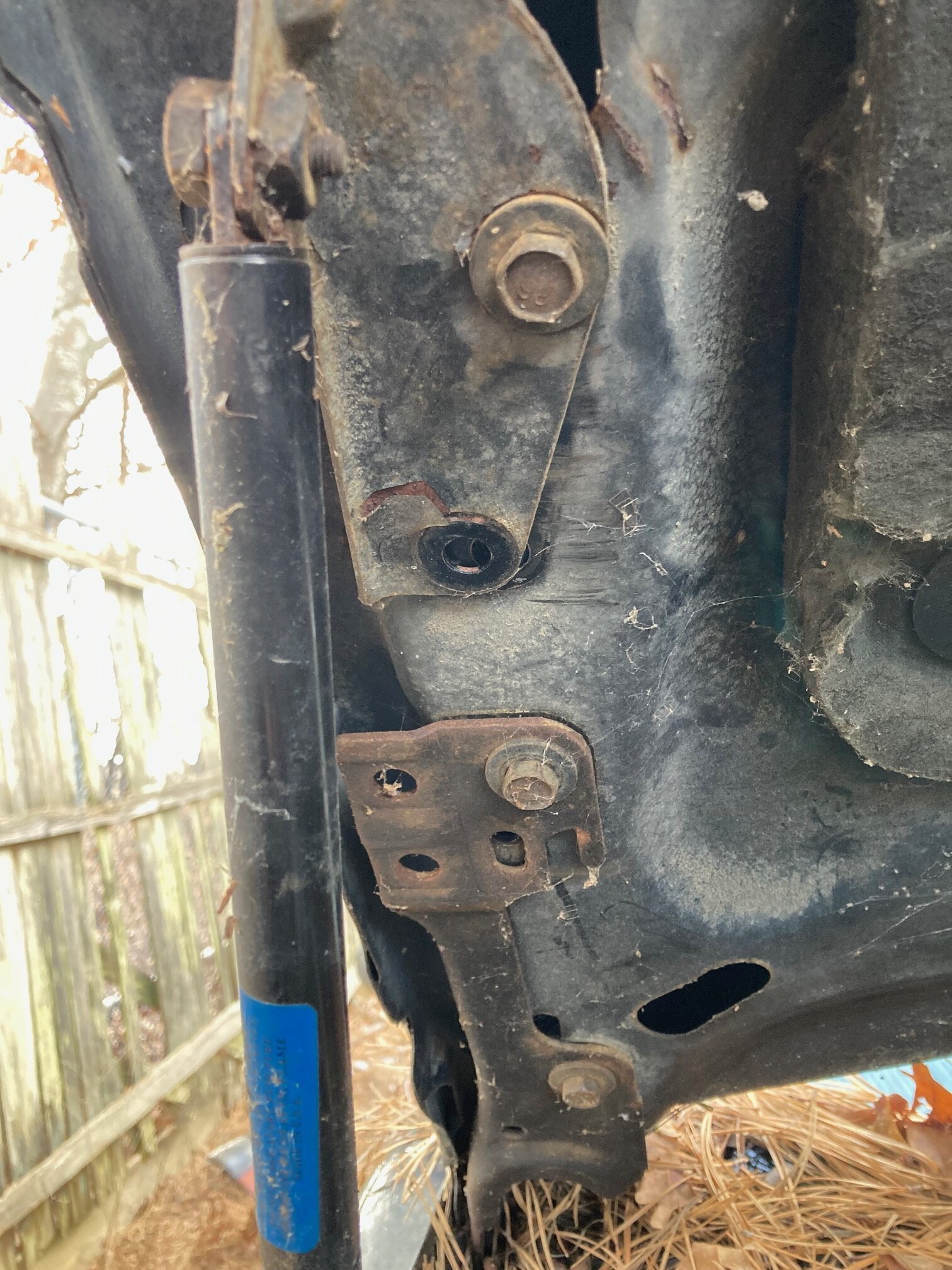

I just installed struts to hold up my fiberglass hood. I replaced one hinge bolt with the strut mount. Pic isn’t of my car, but where I took the idea from.
Reactions: 2 users
Thats EXACTLY what I tried to do with the parts that I put together. If it was the same as a coupe Im sure it might have worked but again, the wagon windshield is at a different angle and the scoop on my hood is longer than a Goodmark. From the front of my hood to the back edge of the cowl scoop its 51".
