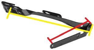

Could the hinge 'bases' all be the same w/the 'spring' leg of the brackets different depending on the model?
Yellow = base portion & Red = spring portion of the hinge assembly??
I can safely say the Regal hinge that uses gas charged ‘hood support’ (thank you olds joe), are different from the ones that use a sprung support.
