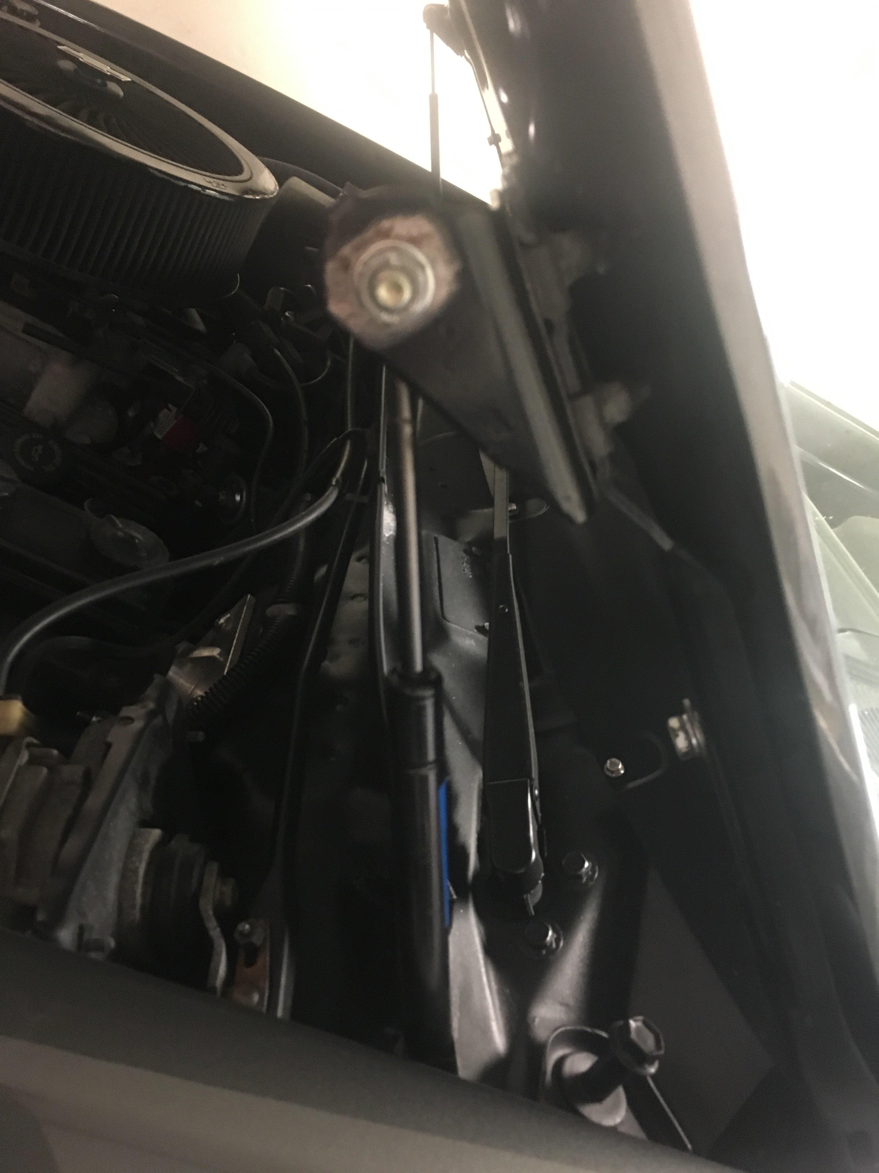

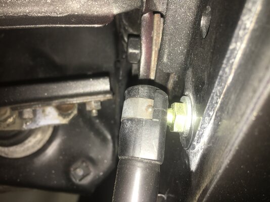

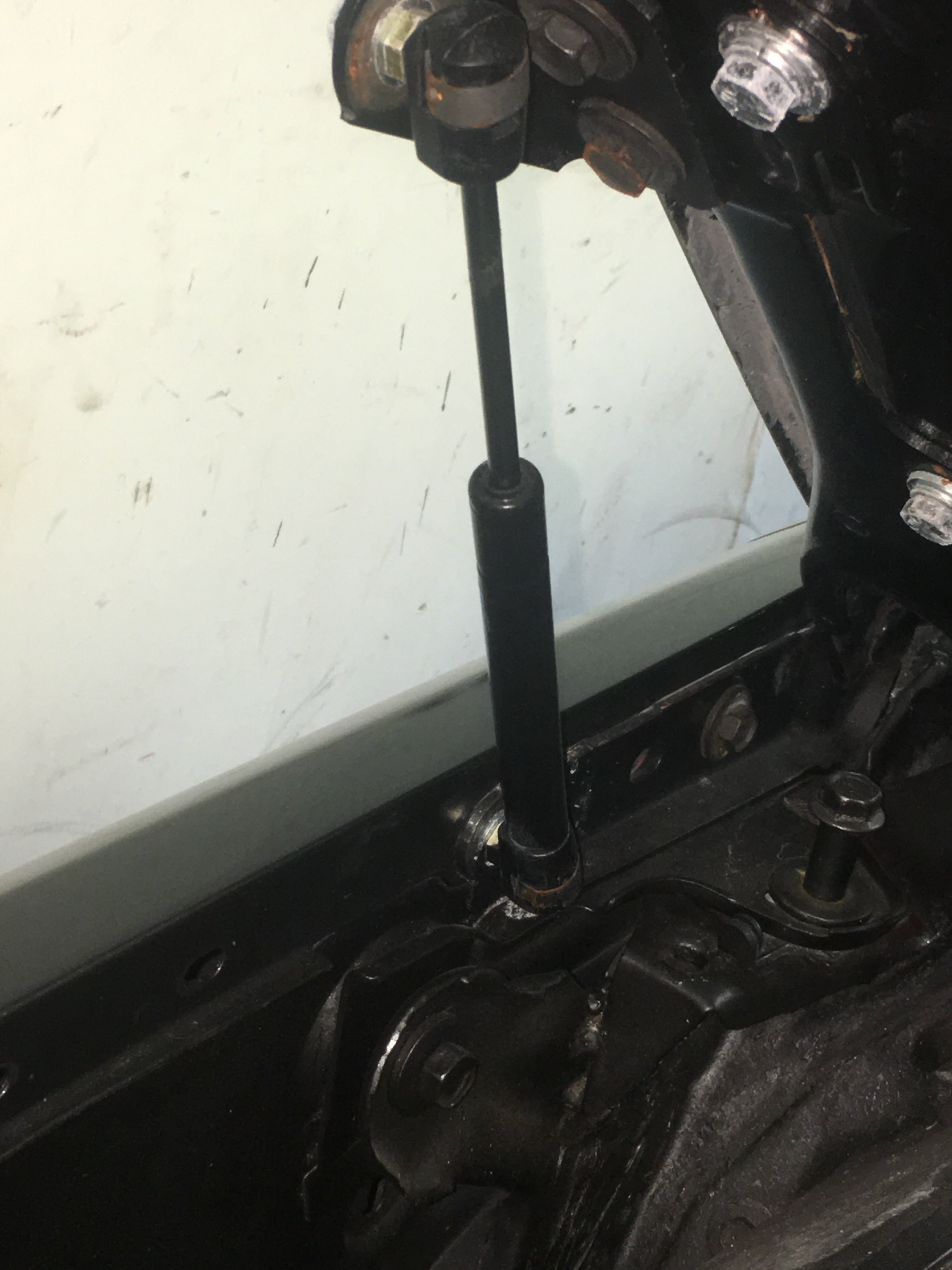

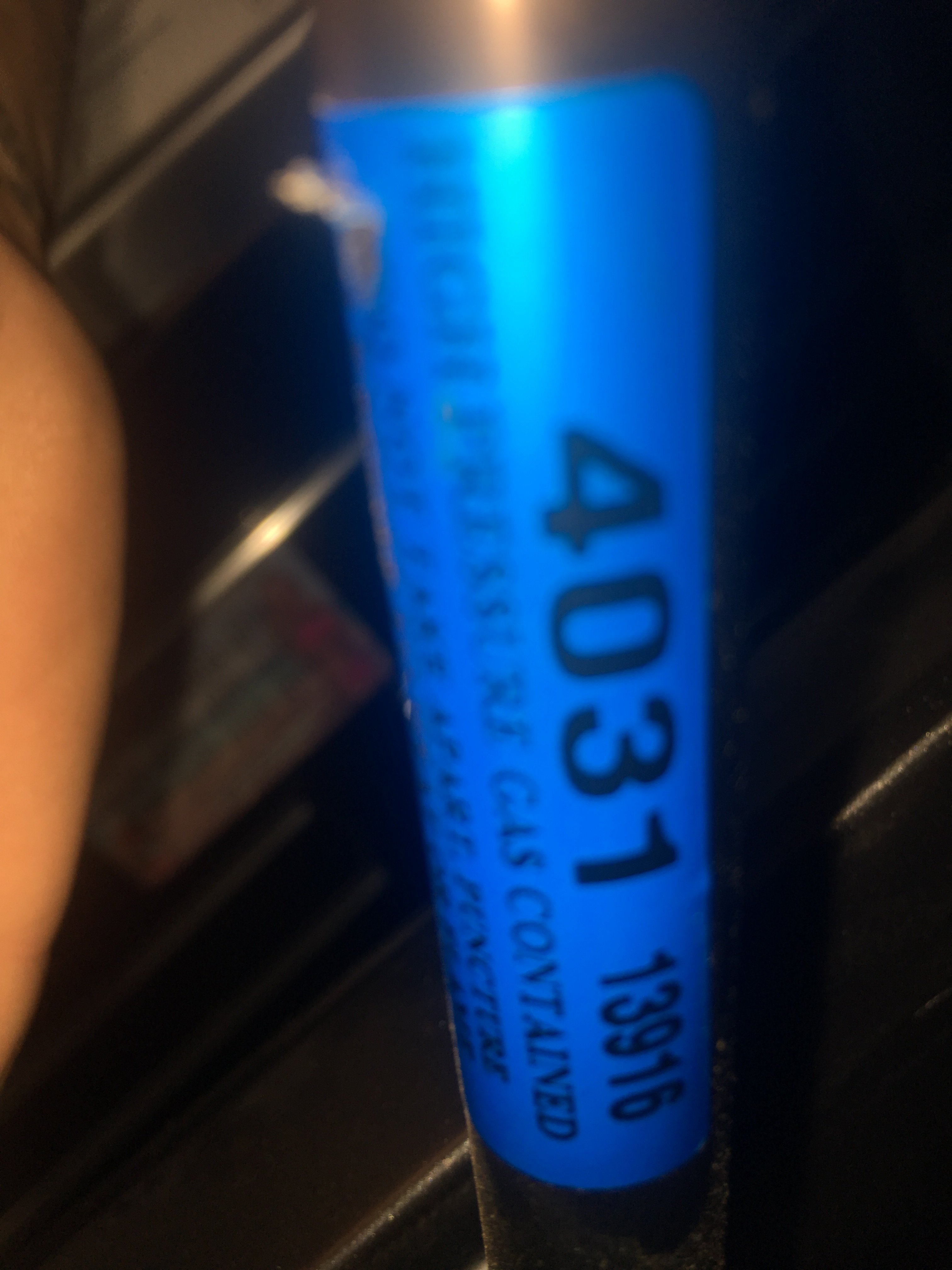

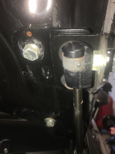

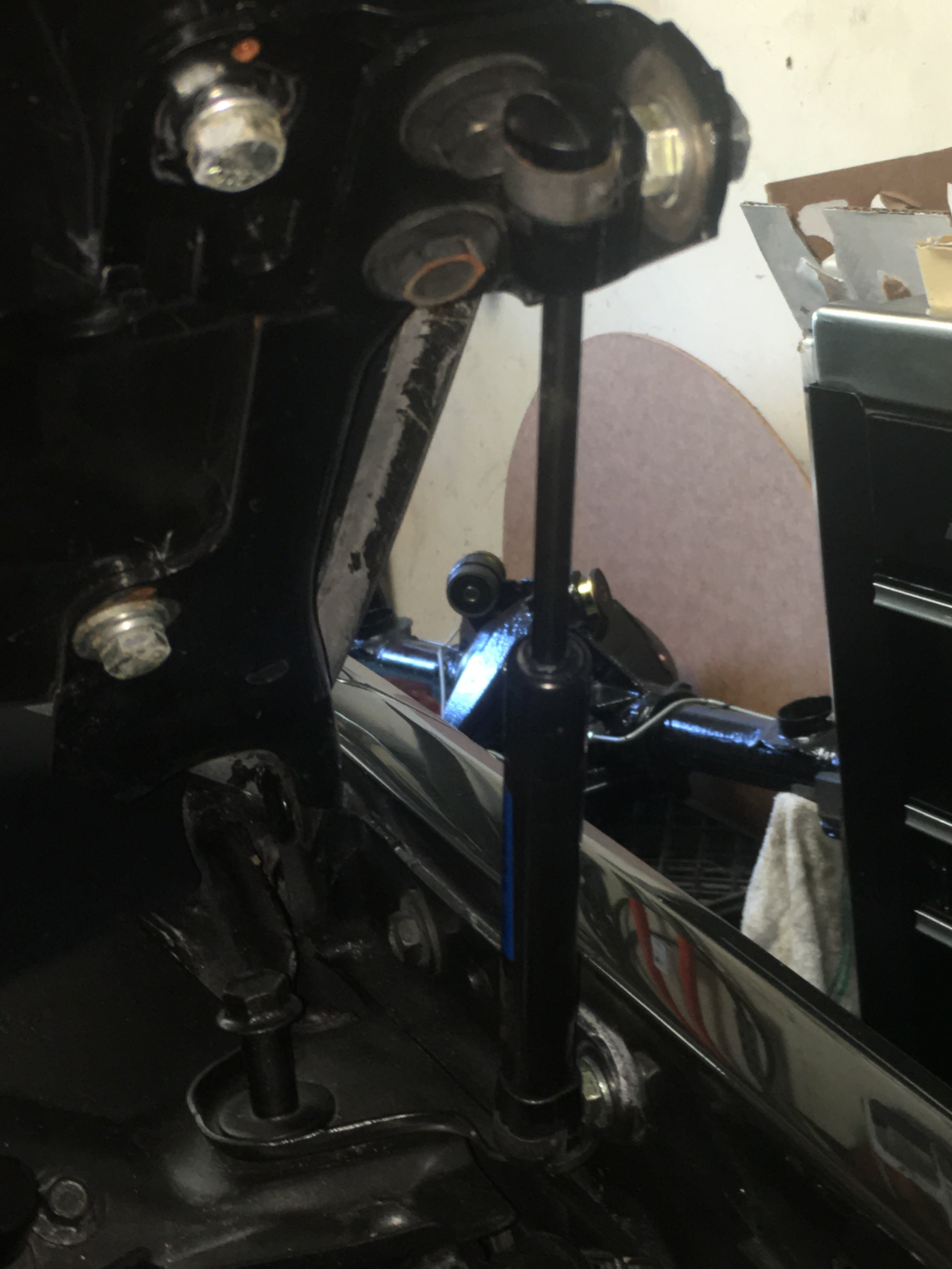

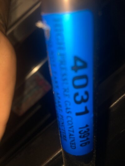

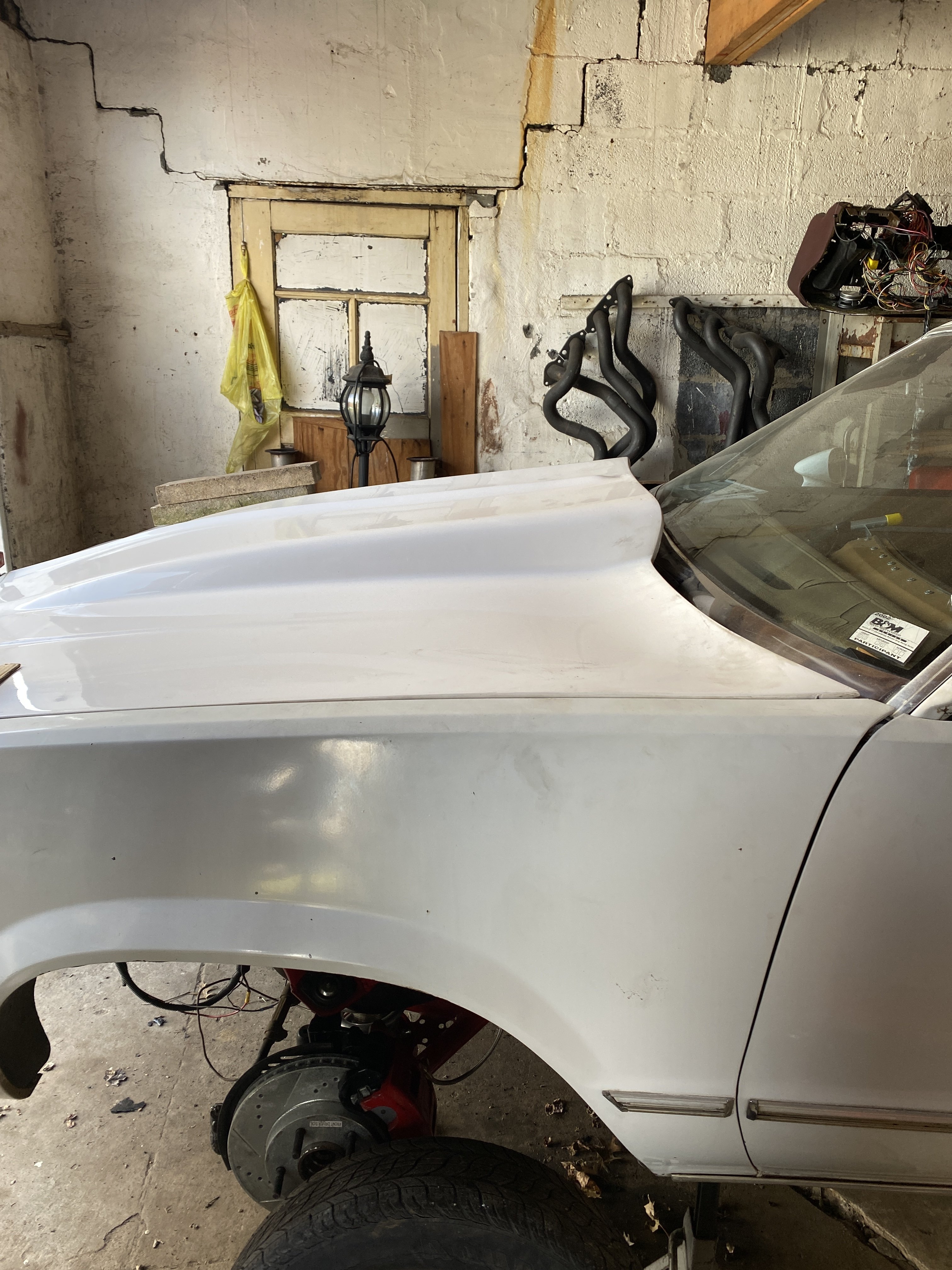

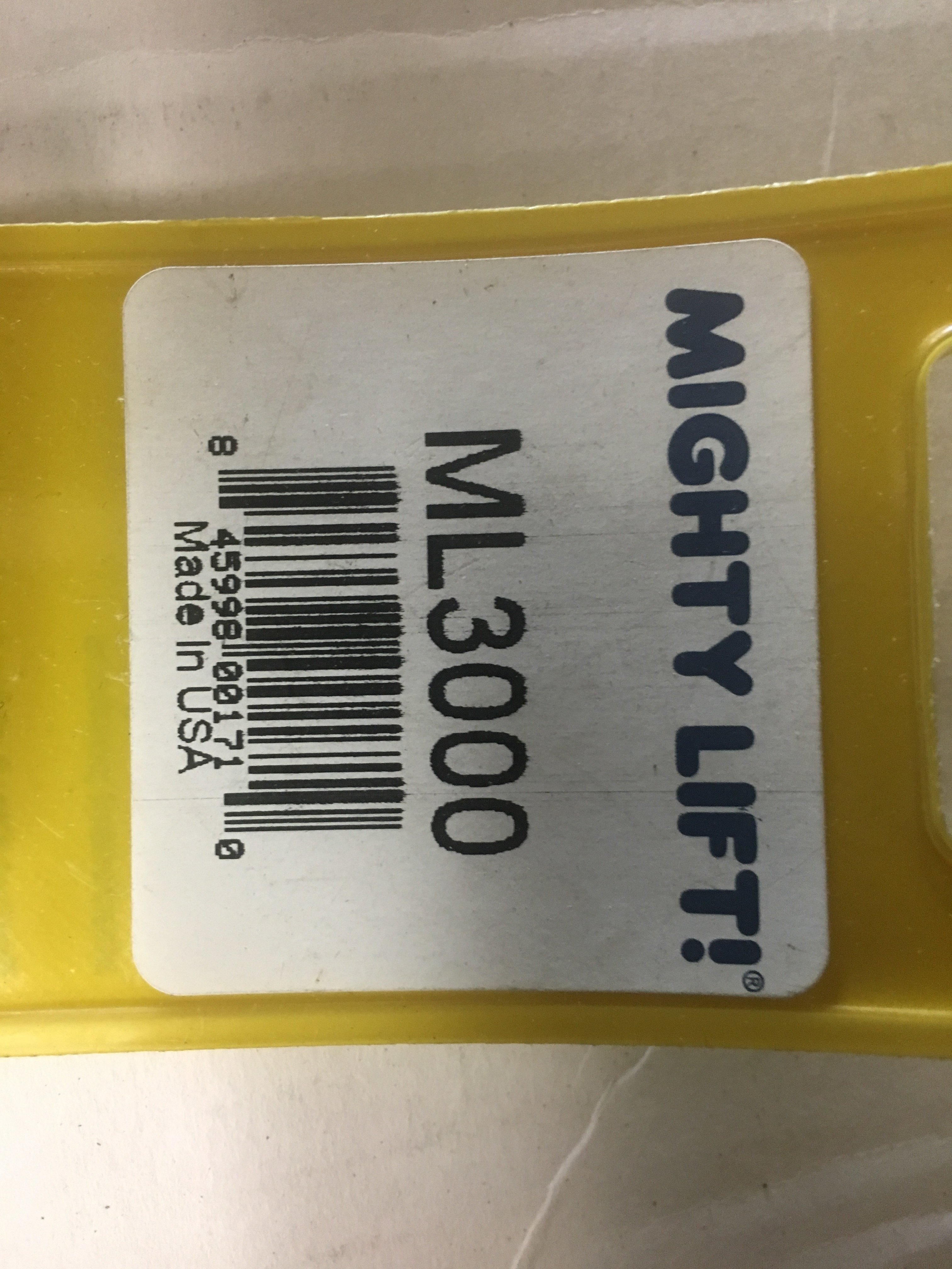

I have a harwood fiberglass hood and have used these shocks. Doesnt bind the hood and holds it up without a issue. These are the parts i used. Using the top mounting bracket from the old hinge. The mighty lift part # is the ball studs that attach to the shock. Found locally at my parts store.
