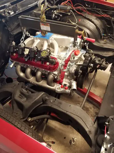

I just put my 5.3 ls with the hooker turbo manifold in my 80 elco and it does fit. I had to grind the nuts on the motor mounts down and weld the motormount to frame but it all does clear.

What bushings and clamshells are you using?
Seems a little tight around that motor mount for my liking. How is the down pipe space around the firewall?
I've been eyeing these headers for a while now.

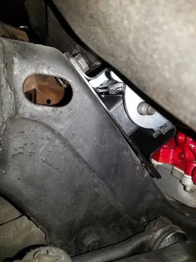

it is a little tight in that pic but after i welded the top of the motor mount to the crossmember you end up with 5/8 t0 3/4 inch clearance all around. everything else clears nicely. i should have it back in the car with tranny and all by the weekend. ill post more pics then. i used the hooker motor mounts and the stock v8 mount on frame.

She is a snug one...

Did you change the original rubber bushings in the stock clamshells? I feel like that's a bit too tight of fit for Holley to give that the green light for g bodies

I got the manifolds wrapped and motor and trans in car. I ended up grinding the boys and nuts down on top side of clamshell mount and welding it in place. Leaves about 3/4" clearance. They clear everything else nice.
