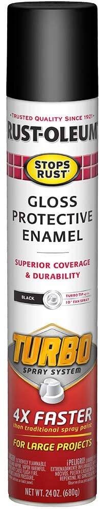

As much as using a gallon of Tremclad, Rustoleum, Krylon, etc is the cost effective and better option - I am not keen on the flash/cure/recoat time they offer being oil-based. According to my research these spray bombs use a more traditional solvent based formula - hence the 8 minute flash time. Additionally, putting the gallon solutions over the remaining factory lacquer is going to make a gummy mess even thicker and gummier to remove when the time comes.
I am only worried about uniform coverage, not finish quality. Looking good at 100km/h and 100 meters away is sufficient until we can get around to doing it properly.
