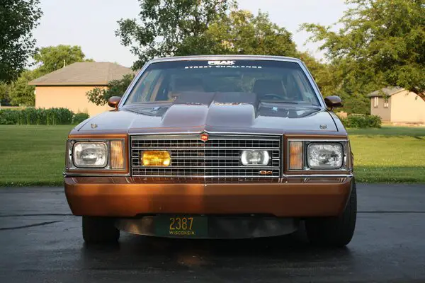

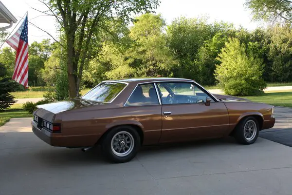

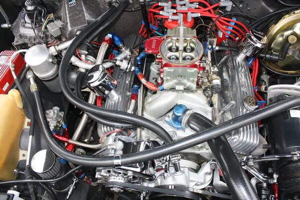

Greetings Guys; Ya I watched it again, at least the screen was bigger! SAD end to a Fine Unusual Outomibile (subjective of course). Little contact with second owner since. Seems senseless what he did?? When ya see the heart of your creation ripped out by a bunch of Clowns it's not a pleasant experience. My wife didn't see it on the computer a few weeks ago so it was her first viewing. She keep talking when I wanted to listen, part of staying married a LOoong time. I haven't seen what the second owner did with the body after the murder, but now knowing his mechanical skills it either sets or he has sent it on to someone else? I've been ridin' this space ship earth for near 75 laps around the sun now & for people that have the talent to make money easy, they just don't place much value in HOURS of labor! What took me 40 years to build was dismantled in a few minutes. Second owner either has bad memory or didn't listen when I told what he was buying? Plus he had the book with everything done to it with the directions. The Clowns didn't have any idea what they had, crane cam, BULL s__t. As many here that read the write ups I posted know it had a Comp valve train. 10.25 compression not 9 to 1 as stated. No Chevy parts except the block, every fastener & part was aftermarket. The strongest & best I could buy. No wonder it didn't BLOW when they let the the b*st*rd try & burn it down. I did notice that the TV version they shortened the burn down, ran out of time. Anyway To all you True G Car guys, Thanks for the many conversations & info, keep on Keepin' on, Ole' Bob.
Ps: The engine looked filthily on the big screen I would guess that second owner never cleaned it?

Was the engine bolted in or welded? Engines can be removed and reinstalled in a car. You did just that. I understand you’re not happy that they pulled it, but it didn’t look like they destroyed the car.

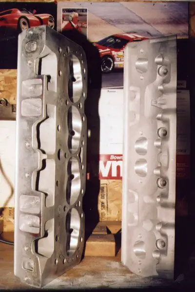

Hi Mr.08 & all; I agree that they didn't do bad to the roller - body. And I had sacrificed the OE block long ago (1984) as it was a thin wall casting. Lm-1 350 & the main webs weren't in a line so it was eating itself. Ran Hot & had little power for a 350". Since it was a thin wall cast (Non Halo car) I thought it would be a good idea to add cubes - Power & TORQUE. A 400" SB was the answer, but theirs's nothing inside them worth tryin' to Hot Rod. Hence JE pistons, Calies crank, Eagle rods & Main caps, AFR heads on & on. So to me the engine was the heart & the body was just a unusual way to get an Super Sport type under body (Anti sway bars- extra gusseting) & heavy duty everything. One step above F-41 so to say. And being an engine man ya hate to see your baby Beat on. They buzzed it to the 7500 RPM rev limiter they had installed & put go juice on top. Any one with 400 SBC experience knows that boost on a GM 400 block will destroy the decks. That's why if we that wanted to get years of use, we only used them in the N/A form. And even then keeping the compression under 10.5 to 1 after about 30,000 miles the decks would be used up. I had built that engine to rev 6500 all day not 7500. So you tell me how much damage they did to the valve train & decks? For laughs they took years of fun from someone that would of been happy with 530 Lbs. ft. of Torque. Eric the second owner could of purchased any other nice roller, I thought he was after the unusual fact that it was a 9C1with all original bolt centers, no cutting, welding, no rust-body damage, only missing the OE engine & front seat. Every other OE part was included for this ONE last 9C1 Two door Malibu. Even the trans was the OE case! OK the diff was out of a Buick. Anyway the car did still have a 9C1 theme (subjective of course). So that in a Nut shell is why It made me Un happy, plus that was the last hand ported heads I did! Ole' Bob.
