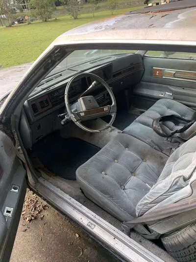

I’m new here & I have an 87 Cutlass Supreme I bought when I was in High School. The last time it was cranked up was probably in 2005-2006. But it’s been sitting on a concrete slap ever since in the weather. It’s still in good condition to me but I want to restore it back to the original look. I just want to know what have you all spent or heard of someone spending to restore a decent cutlass from front to back. Just a ballpark figure…I’ve been wanting to fix it up for years. Any info would help, I just need an starting point!

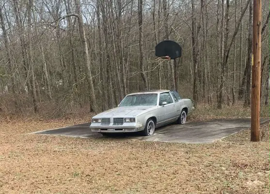

87? Interior looks like 87, the third brake light looks like 87, but the front end/grilles appear to be from a 1985.
If you're going to restore it, how close to original are you going to go with it. First, get a plan, like if you're going to drive it and fix it as you go, or take it down to the frame and start building it up again.
In either case, get a wheelbarrow, fill it with money, then go get another one and fill it with money too. Again, restoration and restification are two different animals and you can spend until your pockets hurt in any direction you go. I've got about every NOS part you can get for a complete restoration, and set aside $13,000 for completing the restoration. I'm still thinking it won't be enough.

The grill may be from an 85, I’m not 100% sure. Everything that’s on it now, was on it when I bought it back in 1999. I just want it to look clean again & run It like an everyday car. I was thinking a 350 crate engine, But I do want to take it down to the frame (I haven’t seen any kind of leaks, but I’m sure it’s rust damage somewhere), especially by the sunroof. I’m a disabled vet & my hands are all jacked up so I plan on to taking it to a shop. Because I’m very limited as to what I can do on my own. But they need to see it (understandable) in order to give me any info on prices. Any suggestions on getting it to crank up (if it’s possible)? I know I need a new battery & drain the quarter of gas that’s left…you mentioned NOS parts, do you by chance have a steering wheel if mines can’t be repaired & dashboard?

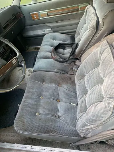

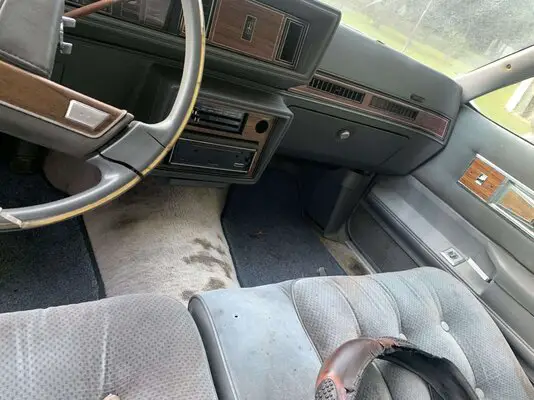

it might be worth your time paying a mobile auto detailer to come out and do a complete clean on your vehicle, inside and out. I can already tell the steering wheel and dash is toast and the interior fabric may be also. I can also see your door seals and window sweeps are gone and will require replacement. if those are gone, what does that foretell for the sunroof seal? the seat fabric has holes and is worn out, so is the carpet. and you've got 4 flat tires that I'm sure are older than 10 yrs.
don't know where you live but based on the pics I'd guess somewhere north which means snow, which means rust. you will need to have it inspected. there are mobile vehicle inspectors who will come out and look at vehicles and inspect everything so that may be worthwhile spending the money for that.
as others pointed out, it will be $$$$. unless you have an emotional attachment to that particular vehicle, you may be better off cleaning it up, selling it, and then buying something a lot nicer for less than what it would cost you to fix this one up.

Nice ride. I sold my 87 when moving shop in 2016, wish I never did. There is/was trend around here to remove the euro front and change to the older style. First thing even before worrying about starting... Get tires aired up, dash cap so it won't get any worse, and seal up the moon roof, sun shield front and back windows. Rear deck is going to get faded out as well. Rit dye on the seats will perk it up, easy to do. I had a YouTube on it. Get tire out of back seat, rubber tire chemicals will off gas out of it ... Damage the fabric.
Did it sit with just water or coolant? And how does it look? Tucson area I've dealt with many that sat several years, I don't even bother any more. I just drop tank clean out and inspect, replace any/all rubber lines with current material, the older lines are destroyed by current pump gas. Seen too many restorations done and car burns to ground about a month after... fuel leaks...
