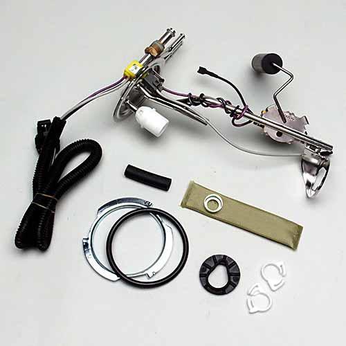

I used that 12-306 pump setup in my cutlass and works flawlessly. Holds 58-60PSI all the time. I'm using an unbaffled Spectra tank.
Dixie Restoration Depot
GBodyForum Sponsor
Oct 24, 2016
137
429
Manchester, CT
The sending unit that you posted is meant for a coupe or sedan tank, the El Camino tank uses a different sending unit. Here is a picture of an El Camino EFI sending unit.
