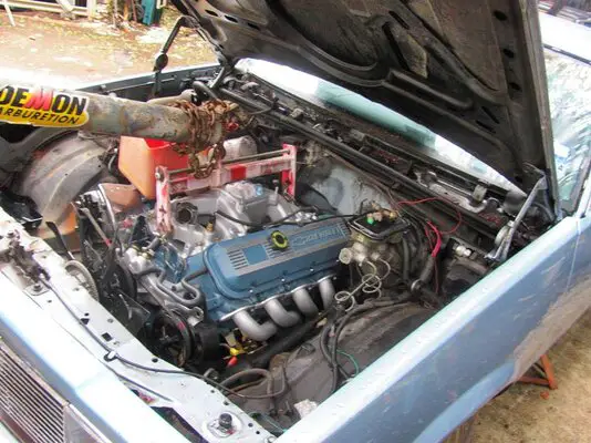

thanks to all for suggestions. I bought the ElCo with a blown engine, so I've never had it assembled/running. I finally got under the car to look around real good and noticed someone has already taken the BFH approach on the factory crossmember, creating an extra hump on the driver side to clear dual exhausts. If my 3-inch pipes fit, we should be OK. Just have to wait for the 40 degree rain showers to go away so I can crawl around under the vehicle.
Hope to fire up the fresh 454 in a week or so.
