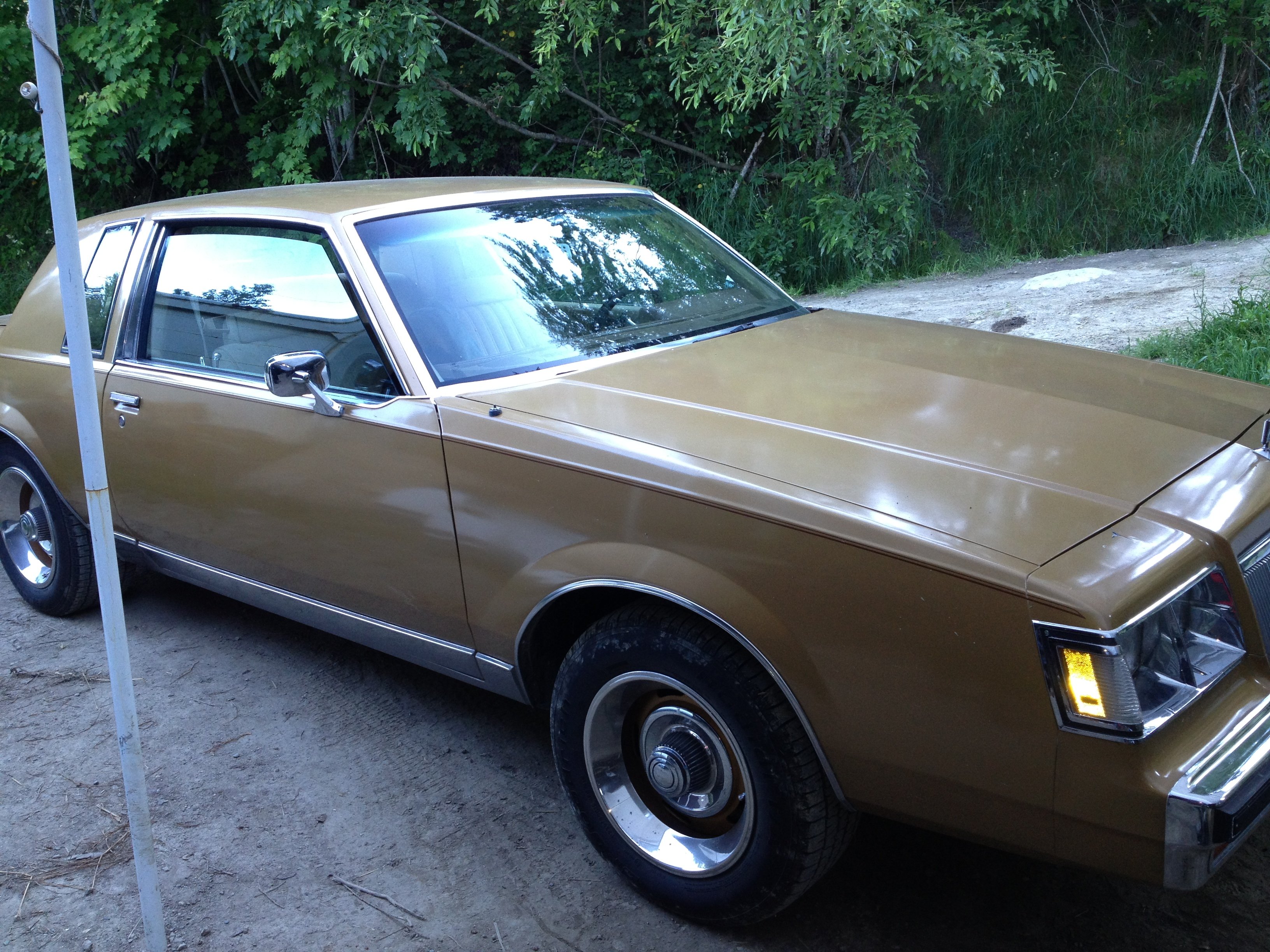

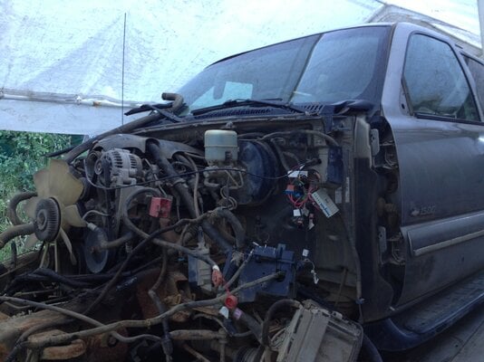

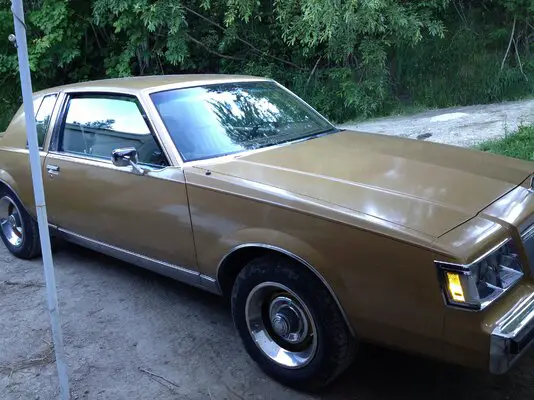

Just starting my first ls swap. have a complete running 2002 suburban as donor going into 87 regal with a built 2004r. My question is this: what all should I remove from suburban? Nobody ever seems to have a whole vehicle to strip on the forums. The wiring/computer is my main concern. I have engine out and harness is next, but do I need the wires to transmission? And is there any way to not have to use the O2 sensors(computer re-flash)? And relax on legalities, I am in Canada. We don't have emission rules where I live. Seems to be an awful lot of wires and fuse boxes. I don't see any of these fuse boxes under anyone's hood. Only have a few more days (week tops) to pull parts before vehicle gets crushed. Everyones 2 cents welcome.
