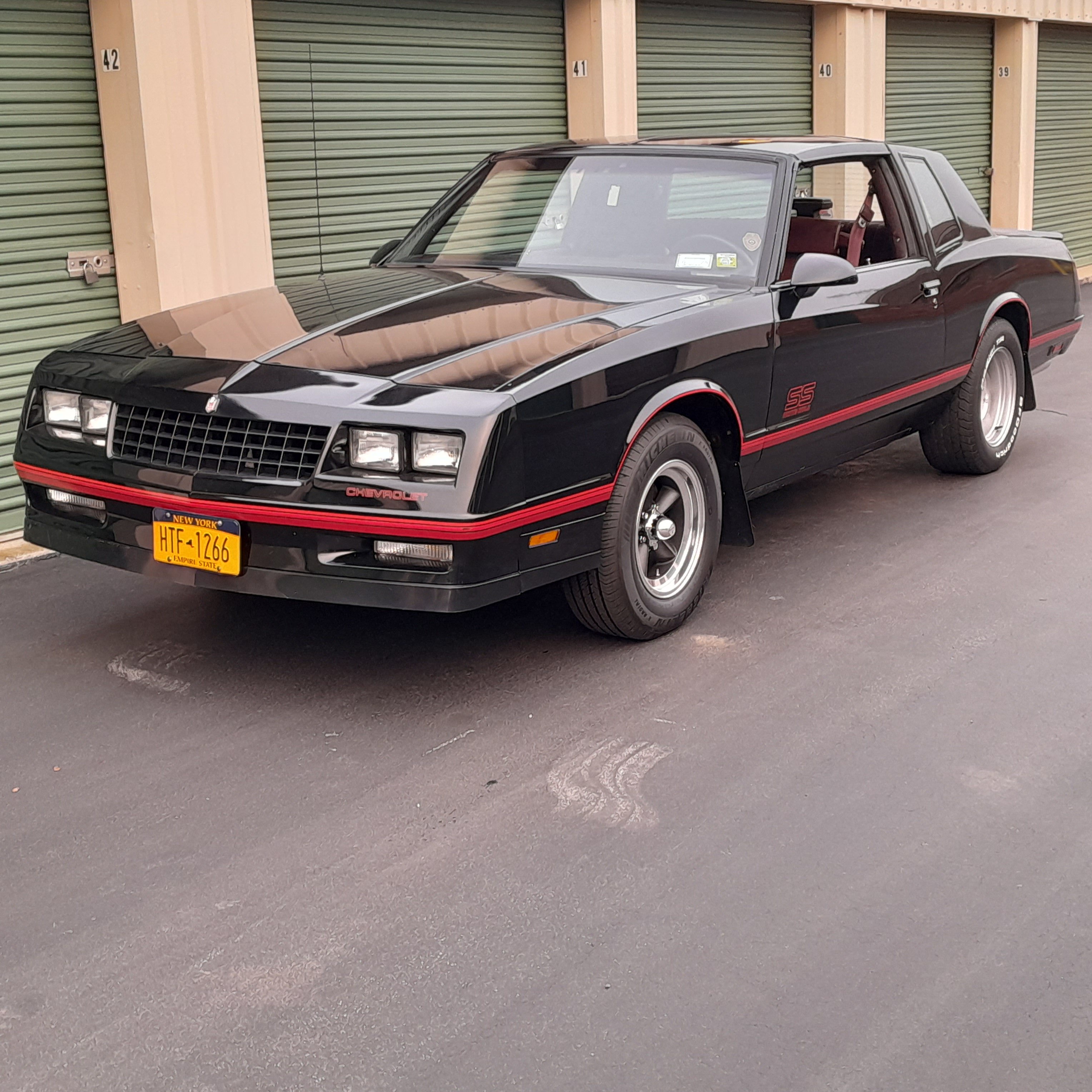

Here goes...
Starting at the front "Chevrolet" script. Top of letter "C" is 3/4 inch down from the style line at the headlight opening. 11/16 to the top of the "T" to be exact on my car. The script is 3 7/8 from a line dropped straight from the corner of the headlight recess to the side of the letter "C". The top of the letter "T" ends up 2 3/4 inch from a straight line extended down from the headlight recess.
Note in most my pictures I started at the 10 inch mark for accuracy with the exception of the distance for the "Chevrolet" script where I used the 50 inch line on a flexible Seamstress measuring tape.
20250327_152317.jpg20250327_152336.jpg20250327_153252.jpg20250327_153329.jpg20250327_153455.jpg
Moving to the sides.
My car being an 88 Monte Carlo SS has the side stripes at 5/8 down from the top of the body style line to the top of the first stripe. The stripe before the wheel on both sides has a slight upward transition and the stripe is closer to 9/16 down from the style line of the front bumper. -Mass production/ Human error-.
Driver side door SS Monte Carlo decal: Top of the SS is 4 1/2 up from the top of the style line. 4 11/16 to the bottom corner of the S from the front edge of the door. The bottom corner of the "M" locates 4 7/8 from the front door edge.
20250327_160439.jpg20250327_161207.jpg20250327_161602.jpg20250327_160816.jpg20250327_161602.jpg
Passenger side door SS Monte Carlo decal: Top of SS is 4 1/2 up from top of style line. 12 11/16 from front door edge to bottom corner of "S". Bottom corner of the "M" locates 12 3/16 from front door edge.
20250327_162931.jpg20250327_162940.jpg20250327_163032.jpg20250327_163041.jpg20250327_163200.jpg20250327_163303.jpg20250327_163310.jpg
To the Deck lid...
SS Monte Carlo script: Top of SS to the bottom of trunk lid 4 3/16 inch. top corner of "S" 1 3/4 from edge of trunk lid. Top of "Monte Carlo" 1/4 down from bottom of "SS". Bottom corner of "M" 8 3/16 from edge. 1 1/2 up from bottom of trunk lid. Bottom corner of first "S" to license pocket trim 11 1/4.
Bow tie above trunk lock: Lowest line on Bowtie 3 inch from top of license pocket trim. Left side kick out at 3 1/4 inch. Kick out corner to edge of trunk lid 24 3/4. Right side of bowtie kick out 3 3/4 to top. Kick
out corner 24 3/4 to trunk lid edge.
Rear Bumper stripes again are at 5/8 down from style line for the most part.
Hope these show what you need.
