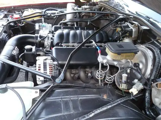

Why run the ugly truck intake manifold? I built an 81 Coupe deVille with a 2013 L96 several years ago. I used the LS3 intake manifold. i ma using the same setup in my 93 S10 Blazer, just a newer L96 (2018). All the parts. throttle body, manifold, fuel rail and injectors are available from Rock Auto for about $800.00 (purchased nearly a year ago).
I have done several LS projects, 2003 Sonoma w/LS1 (currently being changed to an LQ4 w/LS1 intake), 1980 Malibu M80 w/2006 GTO LS2,
1981 Caddy w/2013 L96/LS3 intake and now a 1993 S10 Blazer w/2018 L96 w/ LS3 intake. In my opinion for a useable driver, you will find the L96 hard to beat. My daily drivers "back in the day" were SS427 Impalas. I think the Caddy was as fast and it got 21-23MPG on regular when driven like a Cadillac.
Ugly is a matter of opinion. People including me use the truck intake because it flows better than the LS3 intake. It’s been proven on the dyno that the truck intake performs better. If you shave The truck intake it looks really good. In fact I like it’s appearance better than the low profile car Intakes and you don’t have to spend $800 for LS3 parts and the FEAD. That $800 can be better spent on other performance upgrades. LS3 Camaro and Corvette parts come at a premium while you can buy truck FEAD parts at your local pick and pull for next to nothing
Not mine but just an example.
