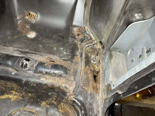

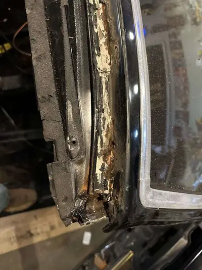

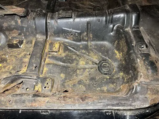

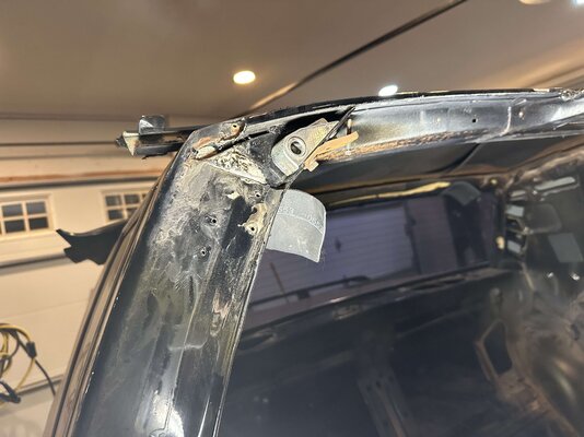

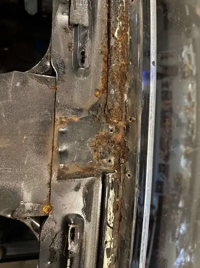

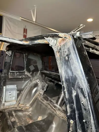

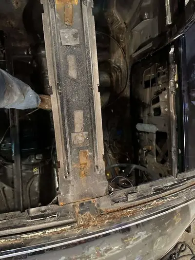

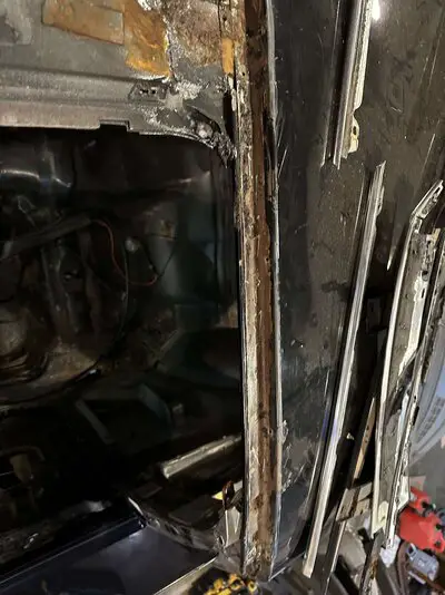

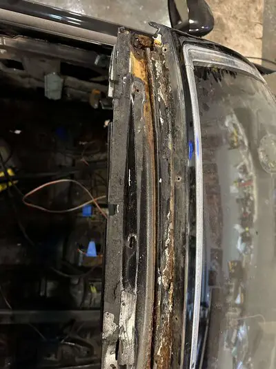

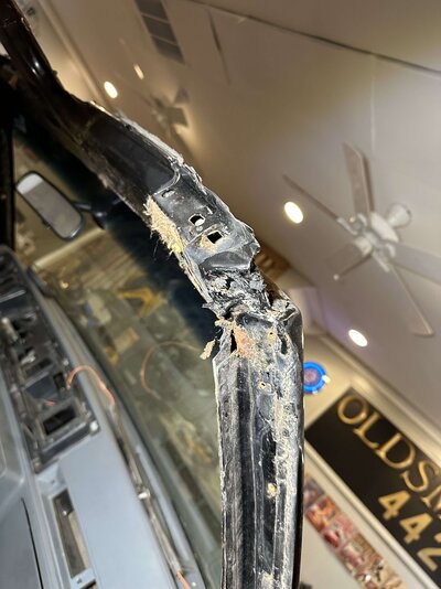

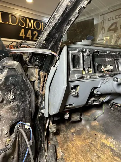

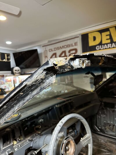

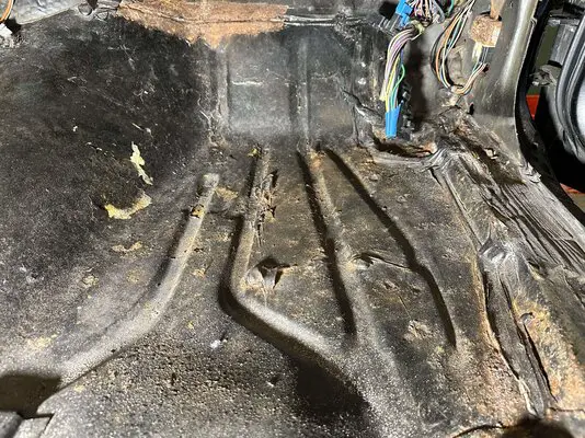

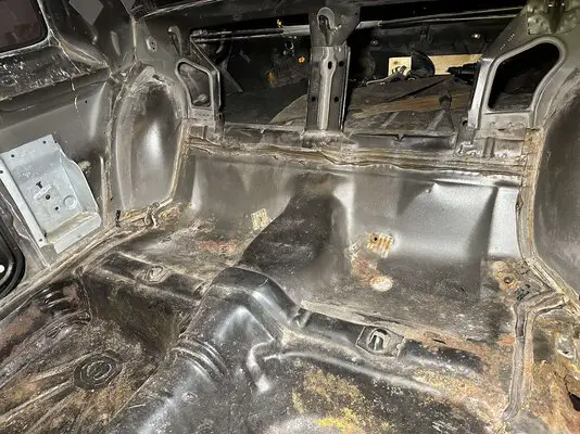

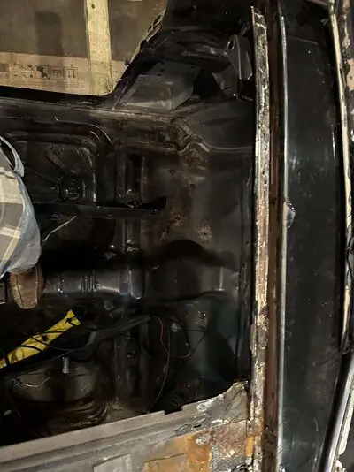

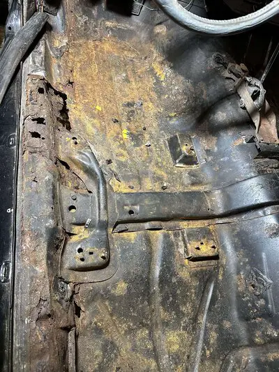

Got another day off today so more work.. love being in the garage. I was worried about the t- tops and what was under the seals so got to work on them. I believe I won’t have to replace the whole header panel but just a couple of pieces. Definitely need to hit it with some rust encapsulation…. I’ll post all the pics. Then I moved on to taking more interior items out and removing the seals and wires going to the back. Vacuum up the rust and access… ok another rust hole on driver side. I’ve gotten some great advice from Nick,rabbithole, and 69hurstolds always has great advice along with others on how to tackle this issue… I’m definitely needing to bend some new metal so the new pan will fit. I didn’t get the dash out yet but it appears at this point a new a pillar and maybe a little metal work in that drivers side door pillar. Good progress for the day… sanity renewed but bank account is going to go down a bit as I head in to order some parts. I’ll try to include the pics now but just know I’m a total product of the 80s and not technical with even the simple stuff.

Maybe it’s hard to orient the pics as to what I’m trying to show but it’s from an angle of looking down on the t tops. I believe it’s possible to remove the front metal where the seal sits by drilling out spot welds and replacing just the metal pieces however if not I know I can replace the whole piece… more work more $$

Find a pile of $$$. Looks like it's not a horror show like some. But still gonna be some work.

Your real moment of truth so to speak will be when you get it opened up and get a peek into the a-pillar areas. Remember, water always goes somewhere in a downwards direction, and, these cars suffered from both the worst of the early recycled steel years and lack of advanced rust proofing on inner surfaces.

Yeah ya know the more I think about it it just makes sense to replace everything with new steel so you know what you have. This is the second time I’ve had this car apart in 25 years so I’m thinking it’s better to take more time to just do it all. It’s not like I’ll have it ready this summer anyway with my schedule. The only thing to do now is find that pile of money.
